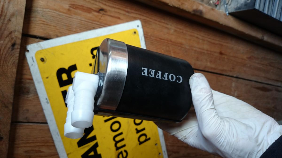

19mm in from rocker cover + 19mm in from the oil filter housing inlets, the 19mm back to the hockey puck - seems legit. mounting on the front panel next to the passenger light/battery whilst dodging that coolant pipe and the SAI pipe (if its still there!)
£55 seems a lot for a box with 3 holes and a few fittings tho? (Yorkshire lad all the way through!)
I made one for a pound...
Will upload a pic once I work out how..
Edited by Octabus

I ended up just piping straight to the hockey puck in the end as the pint inside the tin was wrinkling up and I was worried about snorking a lump of it into the intake!

The pic above is the same one I have sat in my shed waiting for the right day... You can buy the fittings to screw in but given that most other cars rarely have oil breathers any larger than 15mm, you have to question why skoda needs such a big diameter?
I suspect it may be due to the pcv/turbo jet nozzle nonsense they use, so if you are ripping that out (as most people do) to resolve the leeks/broken bits then I don't see why dropping down to 15mm will be an issue. its also easier and neater running the hoses back and forth under the engine bay,
