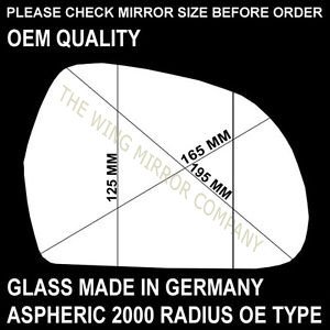

The replacement glass the shops have been getting is like this: post-115762-0-09166400-1452354076_thumb.jpg
And my wing mirror is: post-115762-0-77483100-1452354664_thumb.jpg post-115762-0-01533700-1452354814_thumb.jpg

The shape shown is for the Mk2 Octavia and Superb....the Mk3 Octavia has essentially the same mirror housing as a Mk6 Golf and a few other VAG cars.
Perhaps try a Mk6 Golf glass?
You probably would be best off just buying the OEM part from Skoda though with the backing plate...will assure the mirror heating etc will still work as expected.
