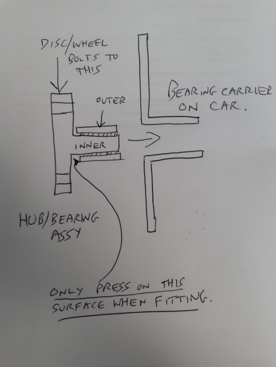

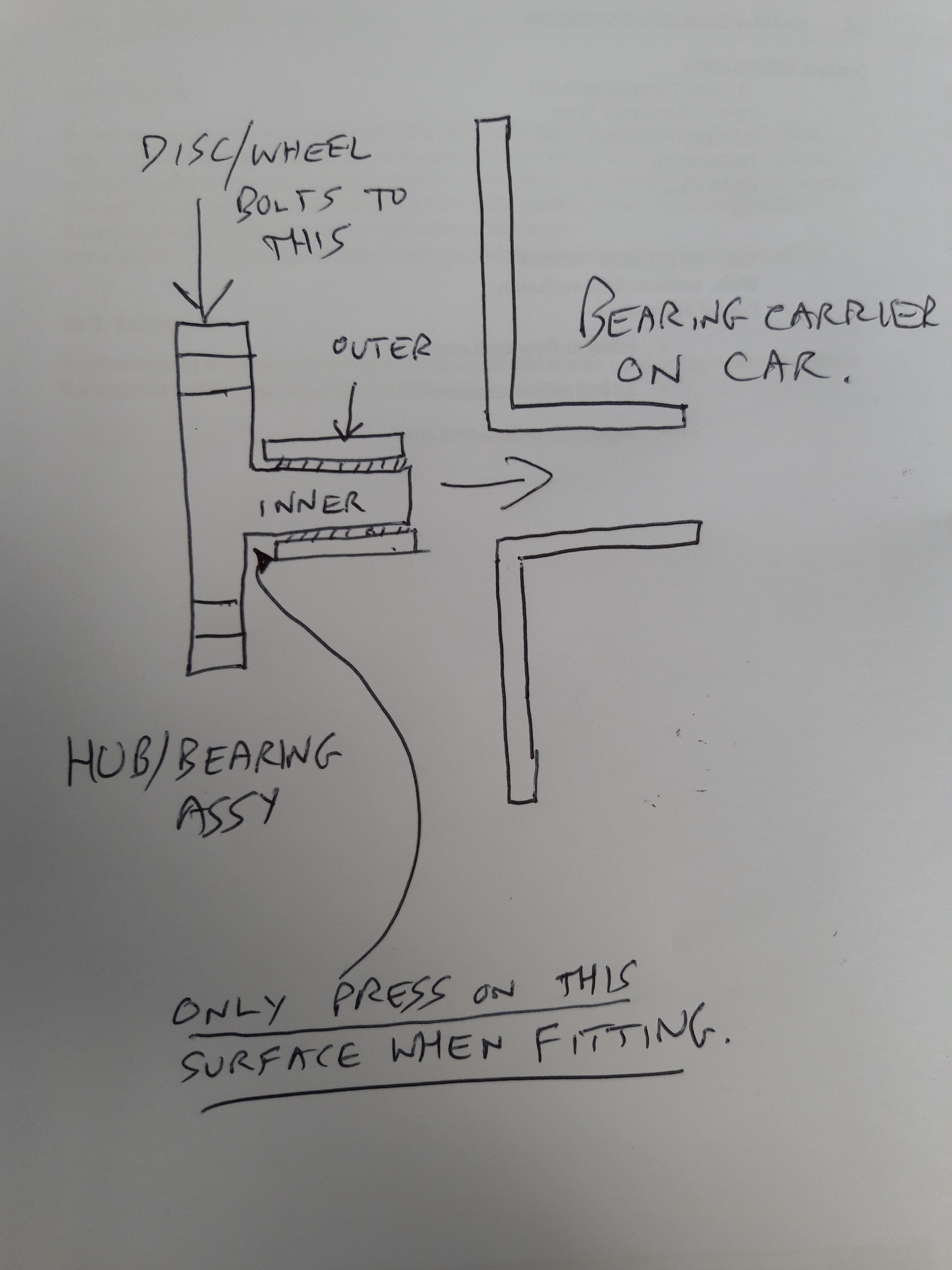

Front, so the hub spins in the hub carrier and it also has a bearing  as well?
Ed
  • Sponsor
Front wheel bearing is captive within the hub assembly. Did you watch the video yet?
Yeah still trying to work it out? Are you saying the outer of the hub assembly with the ABS ring on is actually the hub inner race bearing within the knuckle asembly? There is also a wheel bearing inside the hub assembly is ther not. So two rotating surfaces
  • Sponsor
Does this help?
yeah, i take it the inner and outer dont come aprt so the outer can be pushed in seperately with a normal puller?
  • Sponsor
Correct.
