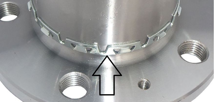

Front bearings require a special tool, rears don't.
what is the tool needed for?
  • Sponsor
If you scroll up a few posts you'll see a video that probably explains it. What a lot of people don't realise is that you musn't use a press on the hub part (that the disc/wheel bolts to) as that is the inner of the bearing. Trying to locate the outer of the bearing into the bearing carrier by pushing on this will damage the bearing, hence the tool which gets in behind the hub. The half-moon parts of the special tool press on the lip shown by the arrow in the photo below.
Rear wheel bearings don't need this, which are you actually aiming to change?  Confused, because the thread you've posted in is front wheel bearings, but the link to the ebay auction is for rear?
