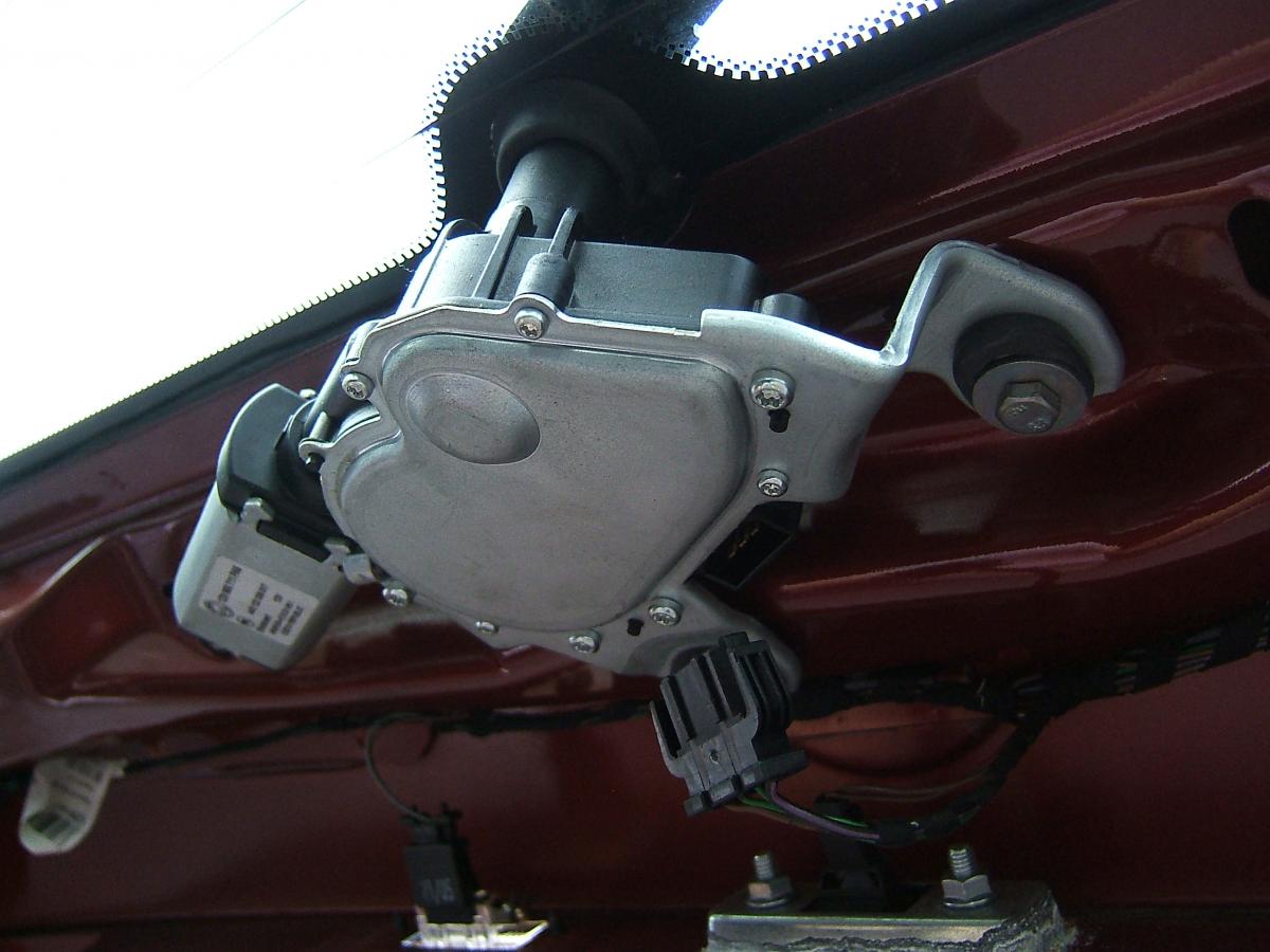

For me my estate motor (both I've owned in fact) were really dry inside with virtually no grease for lubrication at all!
I opened the motor cover (again torx) and covered the cogs in grease and touch wood it resolved both motors so I've never had to buy a new one.
Let me know if you have any questions. I think I still have a post with pictures somewhere.

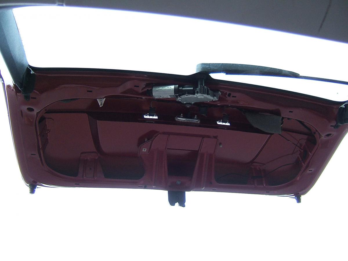

I've added pictures to my post of the cover removed to show you where the clips live and also the insides of the wiper.
All really straight forward screws and bolts to undo. No major surprises.
For mine I used a white silicone spray grease first to get in to all the small areas like the grub screw and then just packed it (and I mean packed) with a heavy duty moly grease that you'd probably use on ball joints and the like.
My second estate wiper motor had even less grease than the one in this picture.
Edited by Plantman
Great, thanks.  Seems you left the assembly in place, and maybe simply worked from inside the trunk with the hatch more or less closed?
Yes true - to a point! At this stage I didn't have the luxury of the window wiper arm removal tool, and could I get the rear wiper arm off the spline!? Could I heck!
You still have to remove two bolts IIRC because the outer casing is all one unit including the bolt holes. It is only three bolts holding the whole motor to the boot lid anyway.
So for this one I just left it dangling off the wiper arm and greased it up.  I think in the end I wanted it fully off so did invest in the tool.
