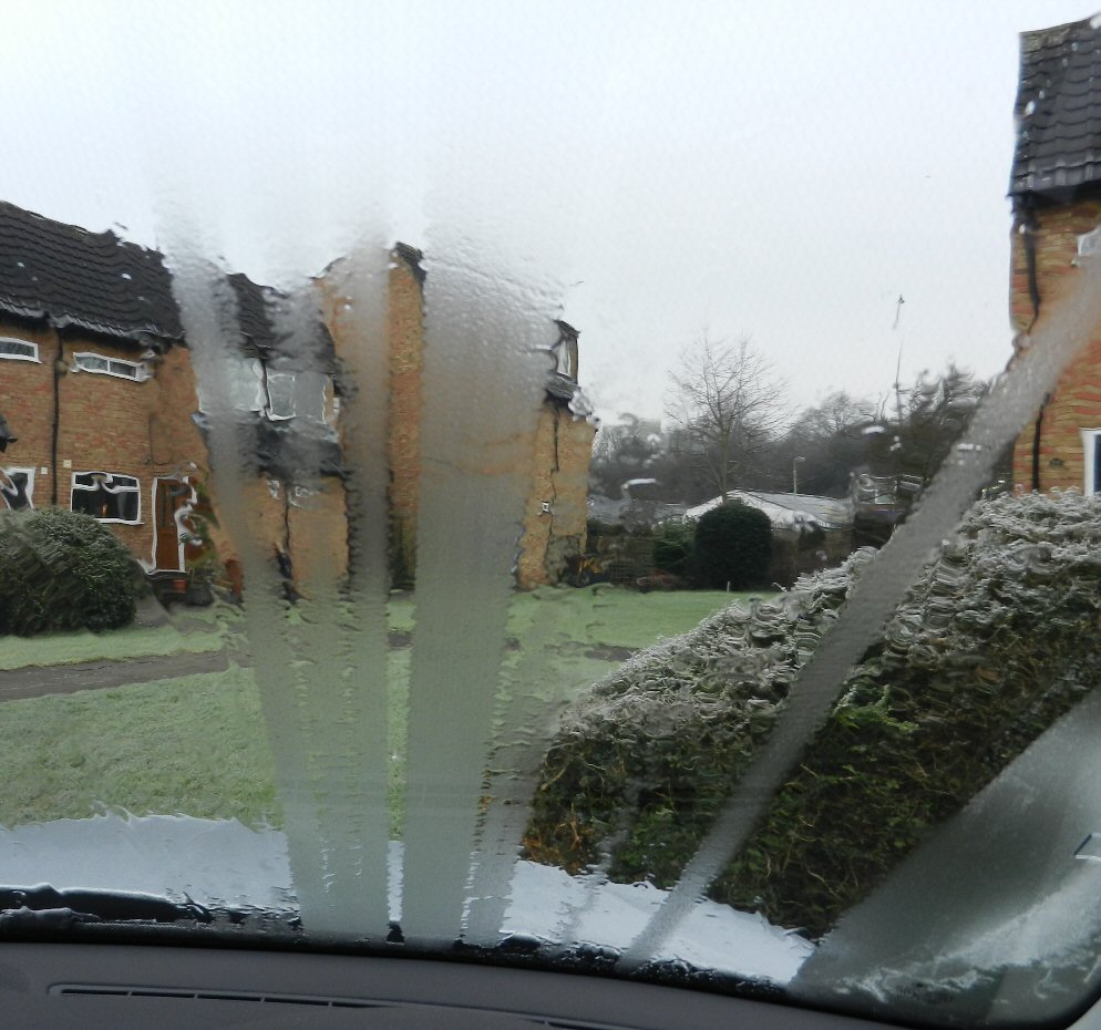

As an extra I had a heated front screen fitted by Skoda when ordered from new.
My problem is some of the elements in the screen have stopped working leaving approximately  4 x 1 inch channels of uncleared ice.
I have checked the screen thoroughly and there seems to be no surface damage.
As my 3 year warranty will be up later this year are faulty heated windscreens covered by this or do I need to go the insurance route.

Contact your dealer about the windscreen and be firm.

yes definitely faulty windscreen, might not be covered by warranty as they could claim it is due to damage...

If there is no evidence of impact damage on the windscreen I would be pushing for a warranty replacement.

Yes you must get the screen done under warranty, they might say get it replaced under your insurance. so say no, the warranty will cover it.  I had my screen replaced no problems.
I had a vertical strip of 2'' from top to bottom that would not clear.
NOT going back to the original source means the manufacturer doesn't get the word that his product is not acceptable.
Like supermarkets, if you don't take it back, like they demand, they will assume there isn't a problem.
Had the screen replaced OK
