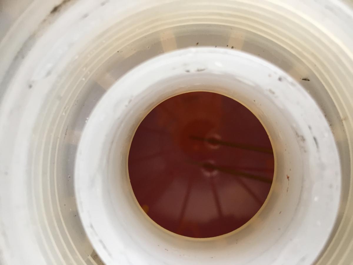

well it about 1cm from the bottom and you can see the 2 wires inside showing. I am hoping it's just where they changed the cambelt prior to purchase (hoping they changed the waterpump to) and there has been air in the system. Can't be bothered to go back unless there is an issues as way to much hard work.
So looking deeper and it's about 1cm down from the minimum. The min and max mark is much lower down than my old monty. I could probably just top that up with water but would like to know what I should be buying other than from the Skoda dealer.
Looking at the manual it say G12 plus plus and says it's purple but it looks more pink to me. (I have attached a pic)

It sounds like after a belt change its 'burped a bubble' and it just needs a top-up.
It's the pink stuff commonly used and the container will have the specs on it - just add ...cold.....on the flat....to the max....n bob's yr fathers brother.
