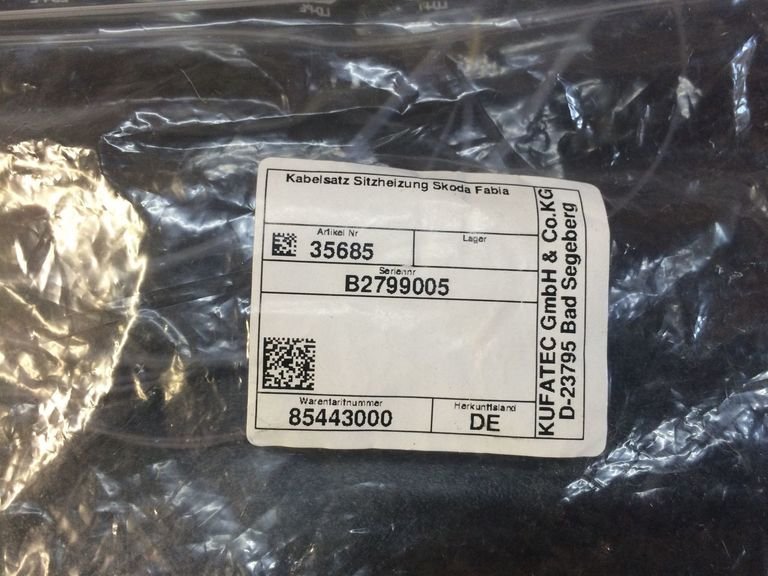

By the way if you google 6Q1971566A it mentions Skoda. (also common to 9N)
Any similarity with the Fabia loom ? Although by looks might only be partial loom for cars already pre-wired for heated seats perhaps. I don't know its just so confusing and so little info for fabias.

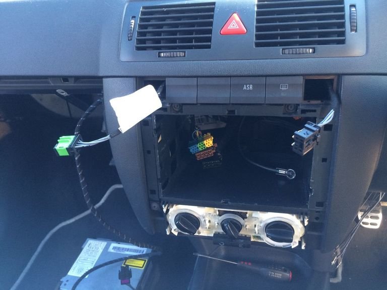

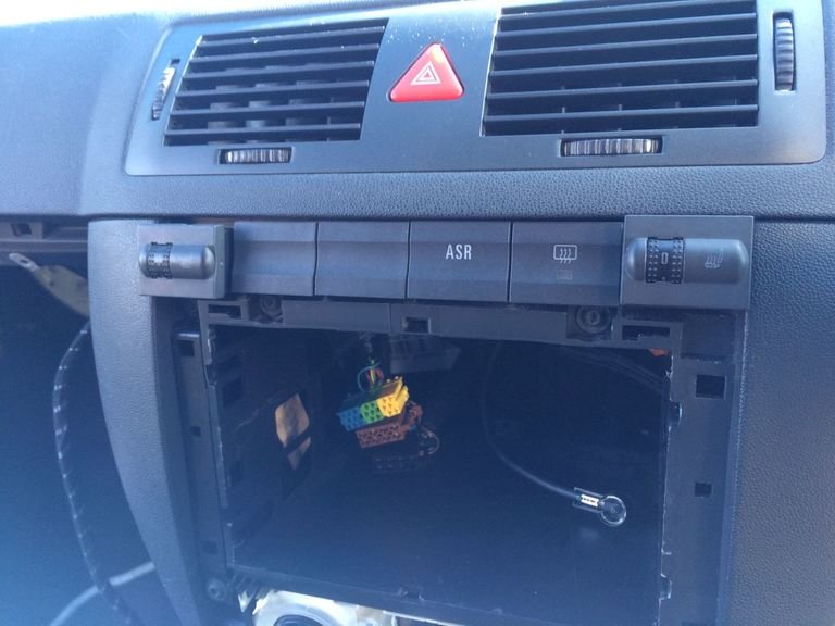

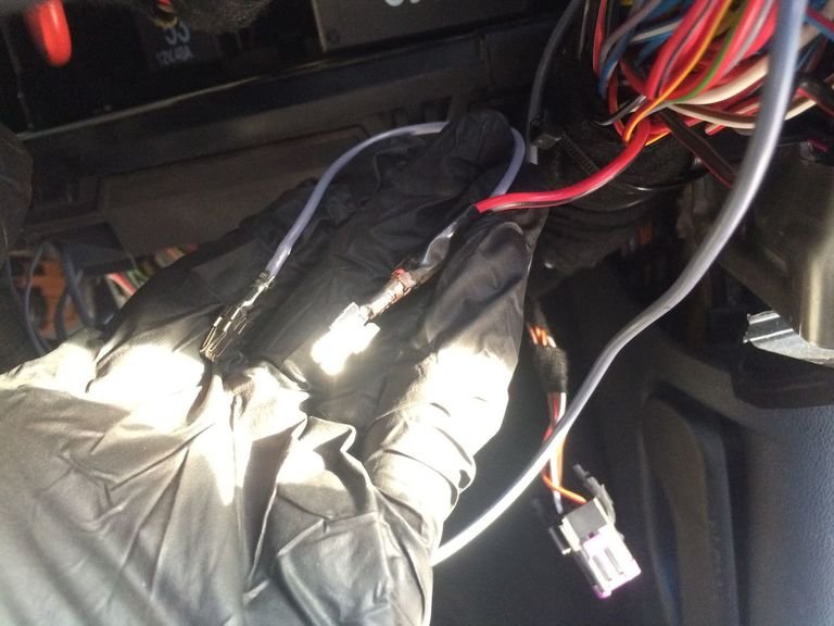

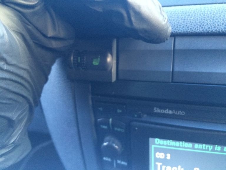

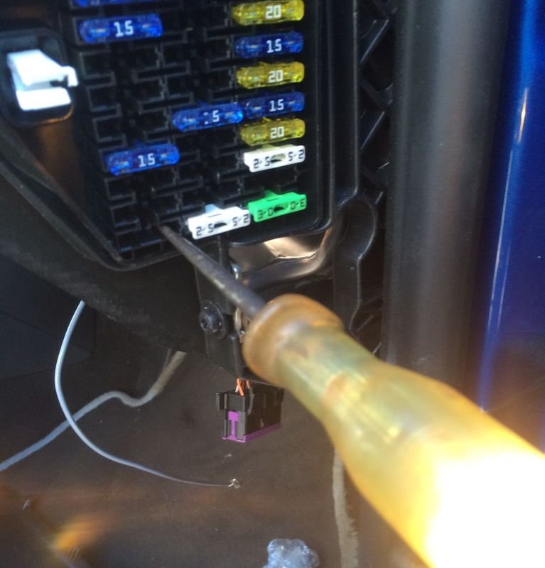

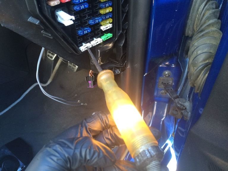

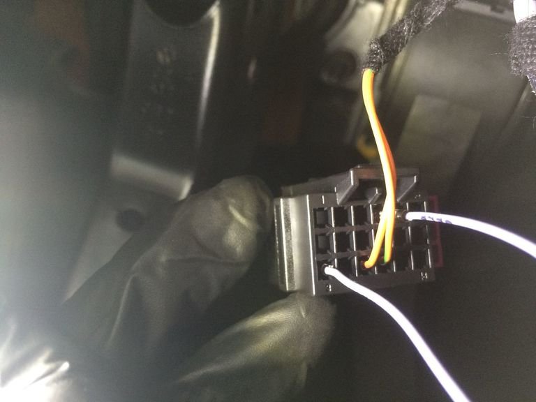

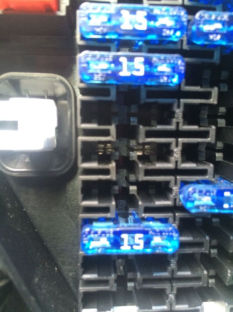

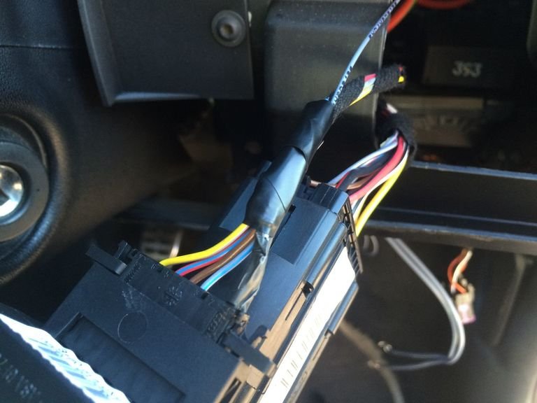

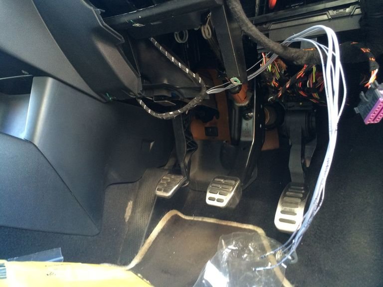

This is very very useful, I have everything else wired in except a switched live - I'll have to get it finished off then!
Yeah, it's not a bad job really, just abit fiddly and time consuming removing trim etc
