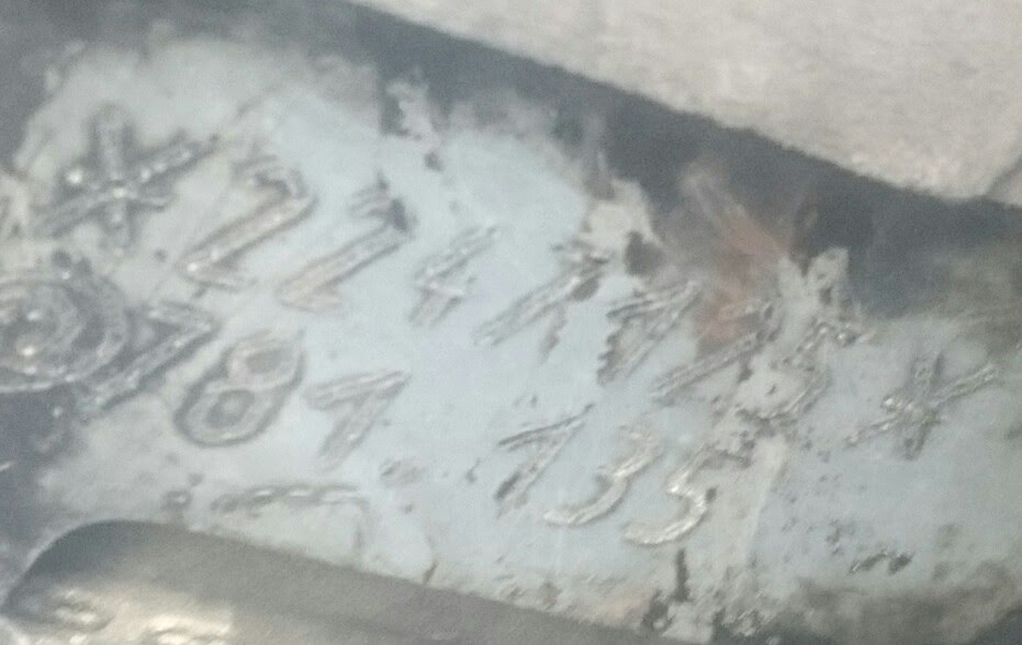

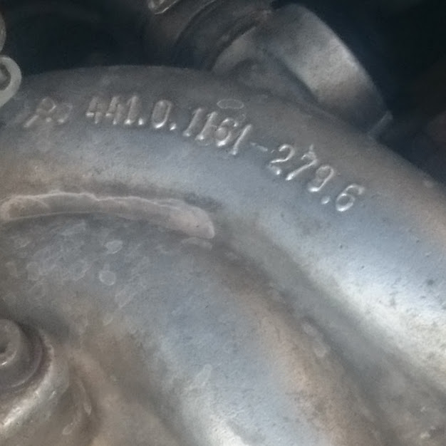

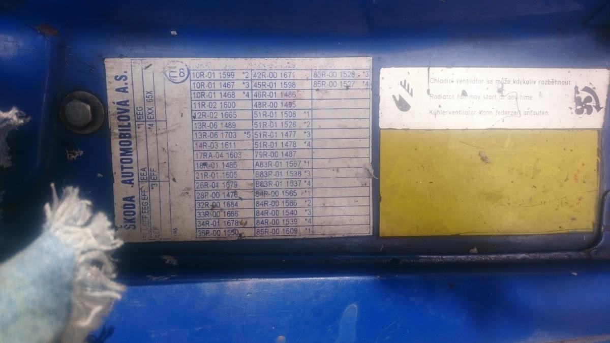

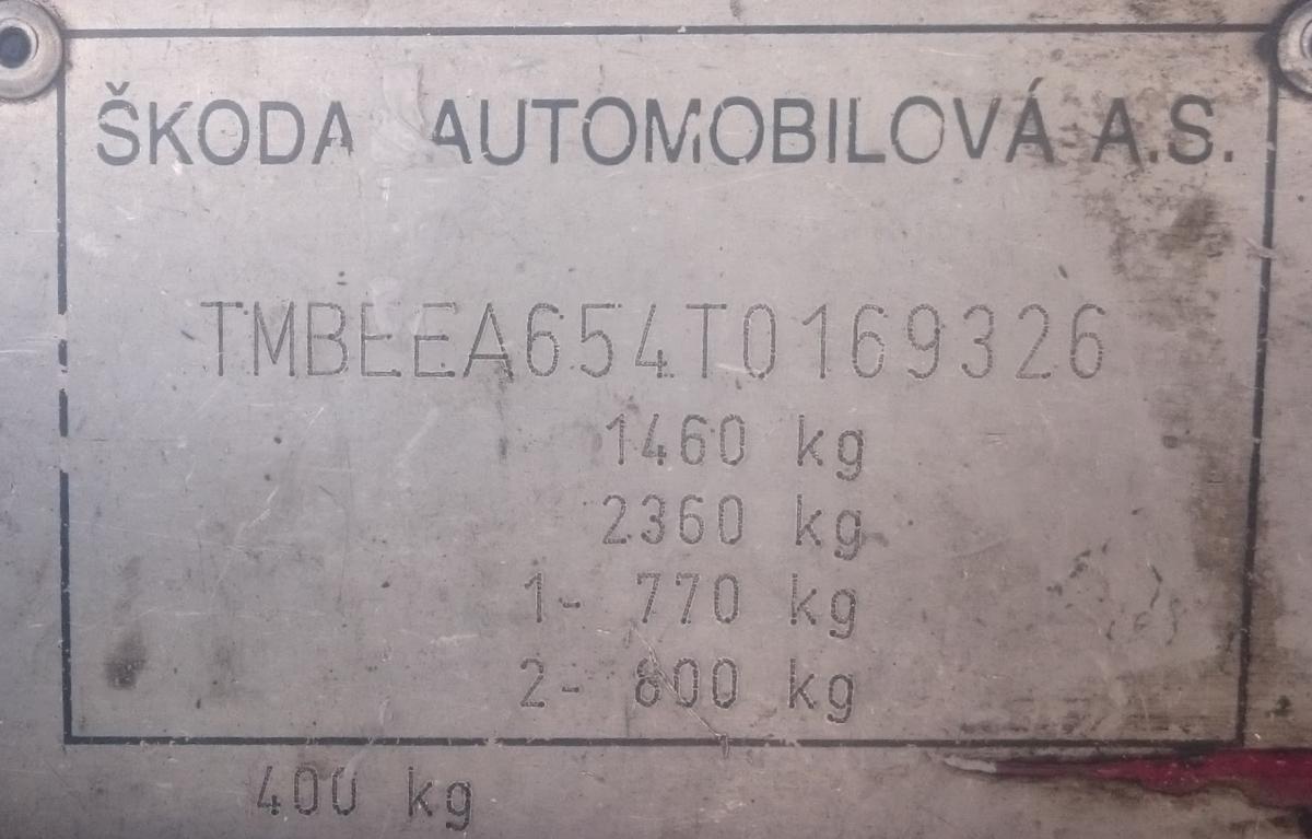

Finally I have a question about my engine model (part number).
Some photos so that if I can help ...
Cheers
post-138515-0-64320300-1455342006_thumb.jpg                      post-138515-0-06661100-1455342034_thumb.jpg                                  post-138515-0-19075200-1455342051_thumb.jpg                                            post-138515-0-03818200-1455342064_thumb.jpg
Engine type: 781.135 or 135 (short)
Body type: wagon
Trim level: GLX
Year: 1996
Serial number: 2247125
