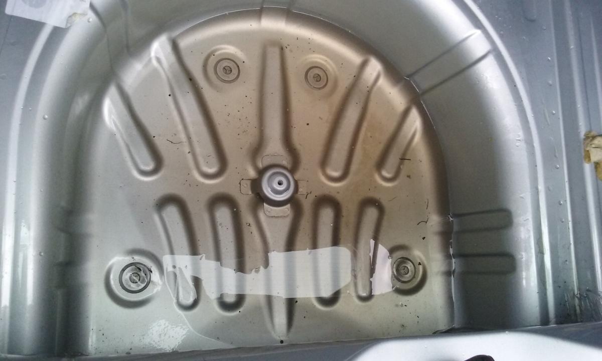

So got the boot emptied and wheel etc out..
Quite the puddle!
Couldnt do any proper investigative work as of course it started raining while i was bailing water out...
However, i believe it is getting in down the back of driver side cluster, and out through the rather "ventilated" inside of the panel.
Shame those rubber (can push up and down) bungs dont want to come out, wouldve made draining it alot easier. Was temptes to just drill on tbh, but didnt want a reall hole in the car!!!
Crumbs that is a bit of a paddling pool, at least you know the source of the leak now

All fixed. If the seal has gone, then they have to replace the whole light cluster as you can't just get a new seal.
Quick follow up - had a look just now as im working from hime today and swmbo is in mid term. Last few days rain since i dried it out on saturday has got another fine puddle in there. Water definitely getting in on drivers side, but not sure if it through/over/under the boot seal or by the light cluster.
Either way rang the local dealers to confirm warranty isnt up until July, so they are taking it in next thyrsday for 2 days to suss it out and repair. Courtesy car on drop iff for the time they have it :thumbup: result

And finally - following dealer warranty works - boot seal dodgy.
