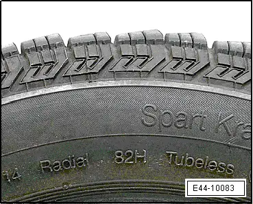

"saw toothing"
Sat a short while thinking about this comment and have never heard it said before
So what do you mean by it ????
"saw toothing"
I think verbally describing it will be easier than typing it.
If you look at the teeth on a blade of a saw, alternately the teeth are higher then lower. Well this is what happens to the tread of a tyre. Each part of that tread of the tread pattern as the wheel goes round over time has worn alternately and because every other tread has a wider gap between them it's as if the car is riding on block points?
And so makes a drone noise. Yeah?
Saw toothing can also can be referred to as 'feathering' or 'stepped wear'.
That explains that, cheers
If you run the flat of your hand across the top of the tyre around the circumference first one way then the other you will be able to feel the "teeth" starting even after a few miles
