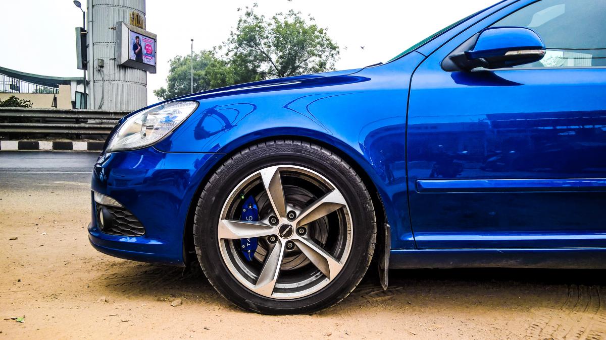

Tarox B32-6 Front BBK
NGK BKR8EIX plugs with R8 Coilpacks
Tires are an Issue here as I just cant seem to find the right size (245/40/17) so am running 245/45/17 which is over the 3% barrier and is locking up the brakes and confusing the ABS.
