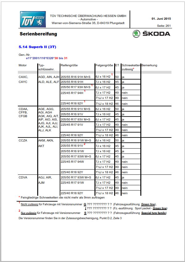

Regarding the Load Index if you calculate the maximum axle load and tyre load index a Superb only needs a 91 LI with 205/55-16 tyres.

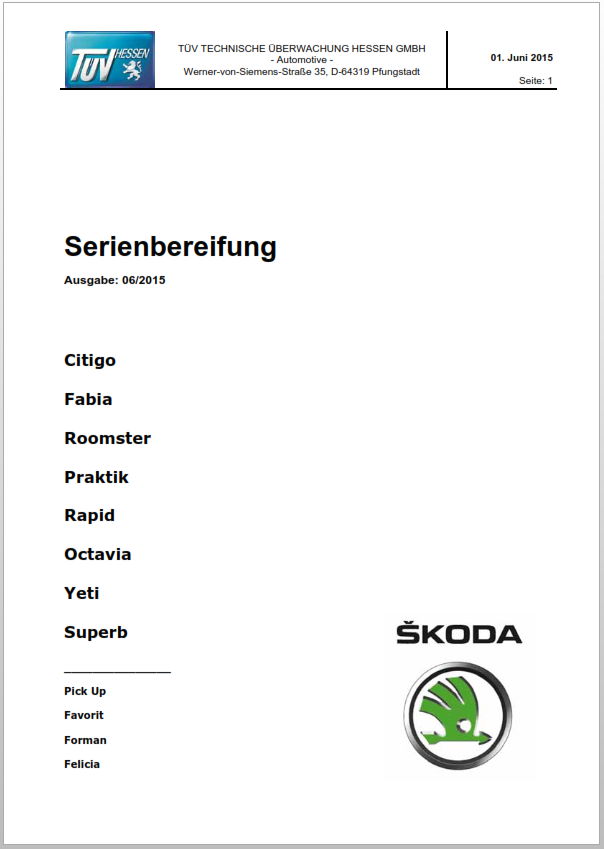

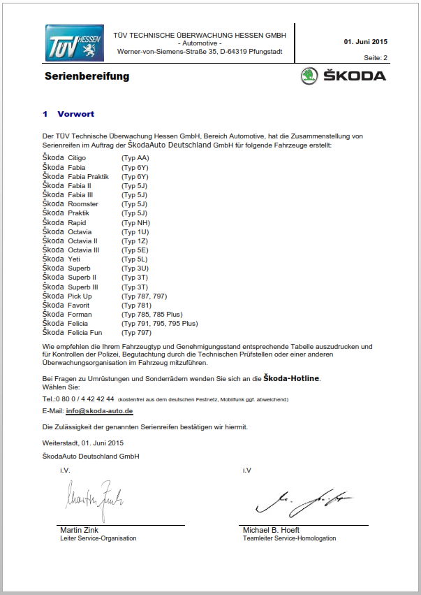

I also downloaded a Skoda document on all their tyre combinations when we bought our Superb estate last year.
I cannot upload the whole PDF file as Briskoda only takes 2MB files, but I took screen shots of the first 2 pages and page 261. On there it lists a few engines and states LI 91.
Before the Superb we had a V70 which is even heavier and they were happy with a LI of 91.
post-127902-0-31550300-1457264306_thumb.jpgpost-127902-0-74372300-1457264306_thumb.jpgpost-127902-0-16007800-1457264307_thumb.jpg
