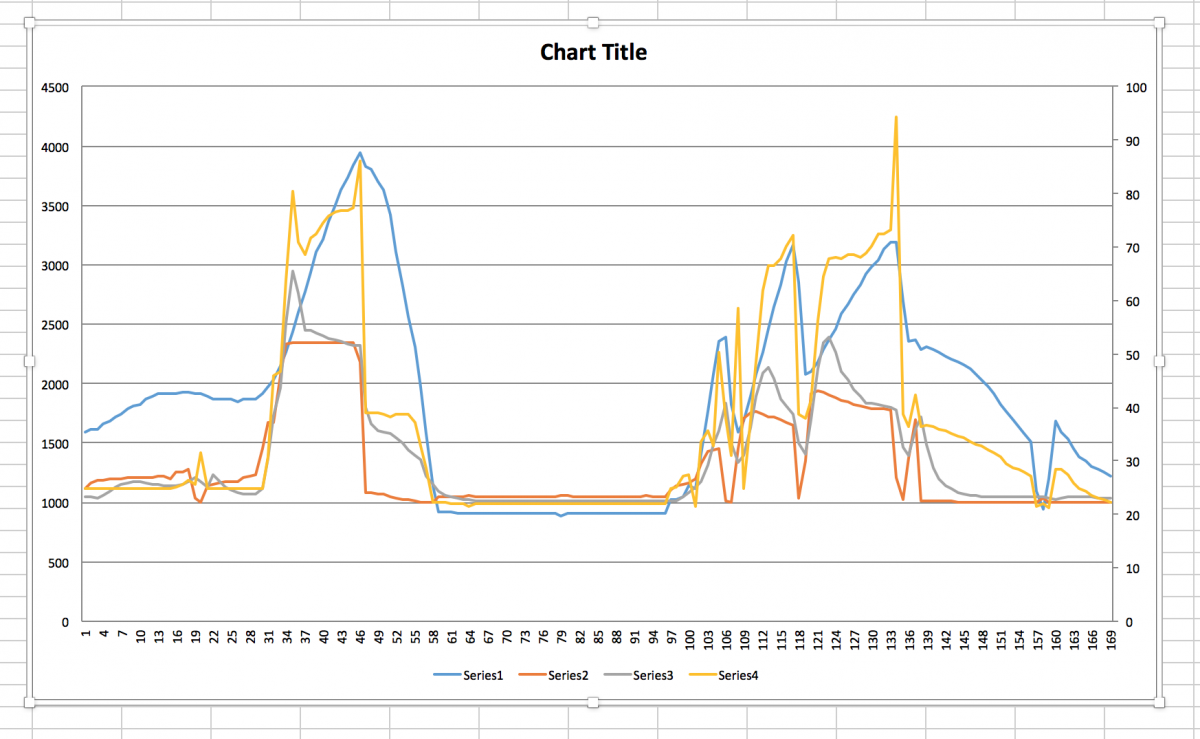

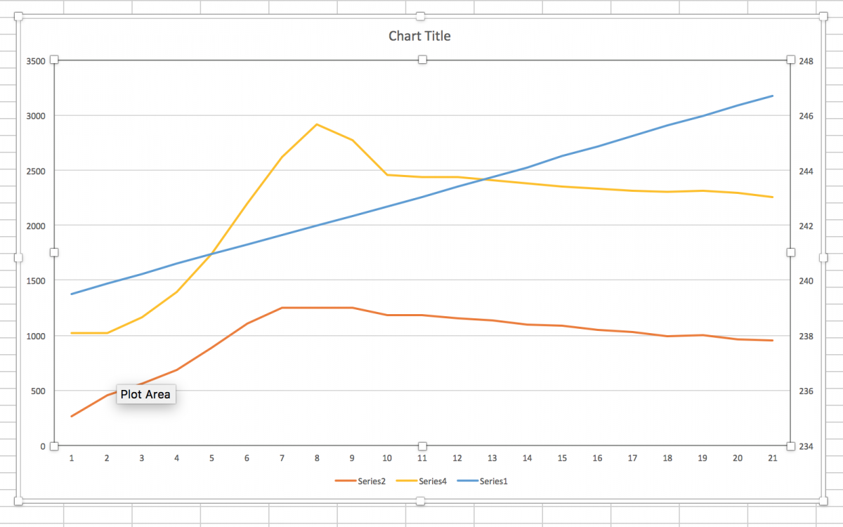

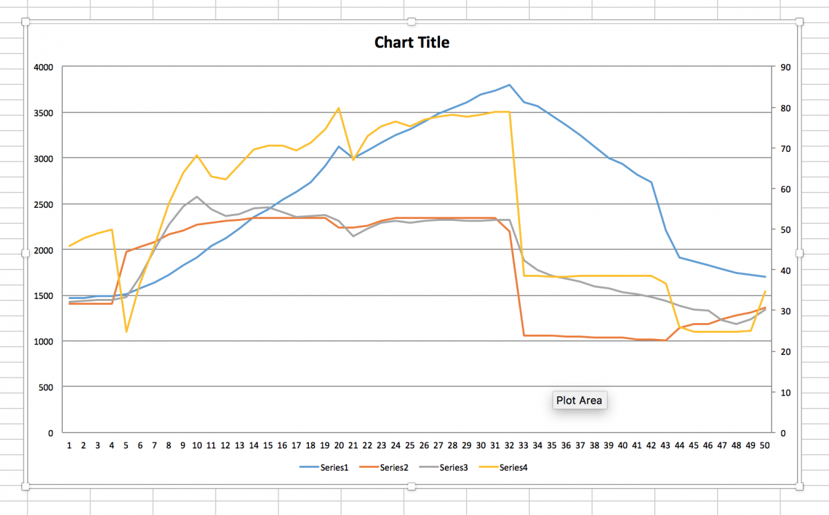

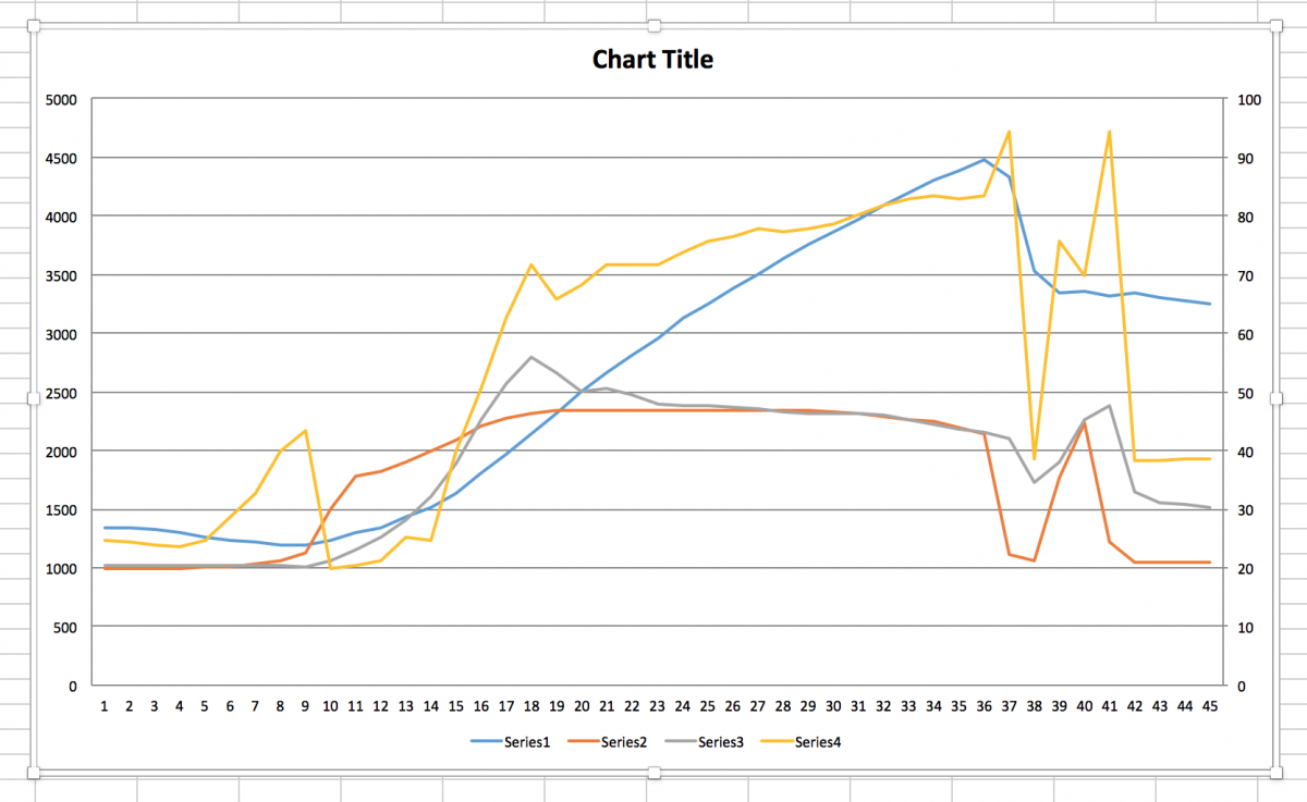

Today I logged a few runs on channels 10/11 and although the car pulls nicely, I think there is still something wrong.

I've attached my logs and graphs. Anyone suggest what could be wrong or what to look for?
