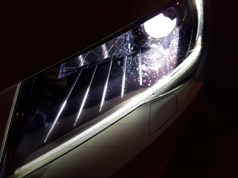

I am worried only about one thing - everynight after i stop the car i get  condensation in the headlights. I don't have this problem during the day when only the day lights are on.

Very common this time of year. Air in the lights is hot, outside is cold.
Unless you have a puddle forming inside it's not a fault.

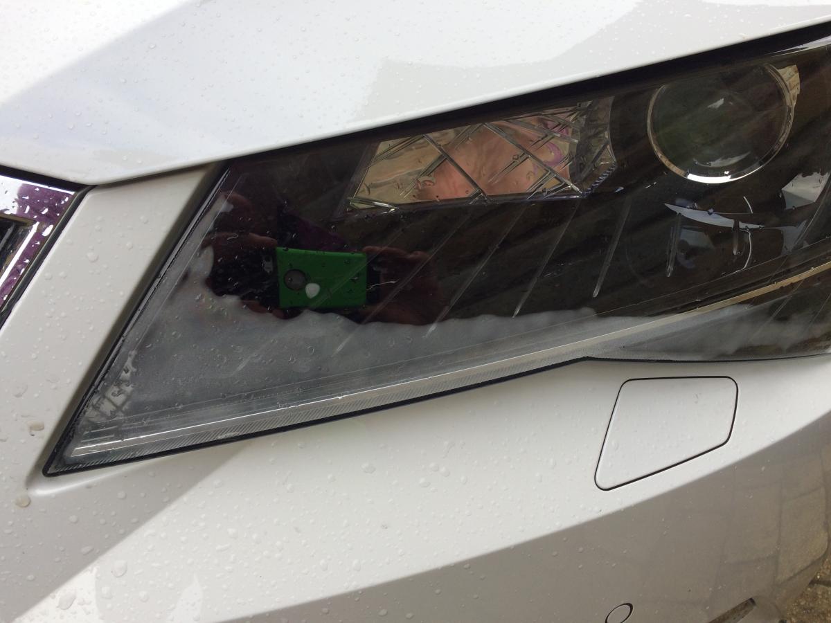

post-61647-0-17625300-1476200184_thumb.jpgI have condensation in the nearside headlight glass. I'll give it a few days to see what happens.
attachicon.gifIMG_0997.JPGI have condensation in the nearside headlight glass. I'll give it a few days to see what happens.
It's OK Phil. Mine does it from time to time. It's because they arnt sealed units. It goes away. Did it more last year in cold weather. Cant remember it happening at all over the summer. I was concerned at first...

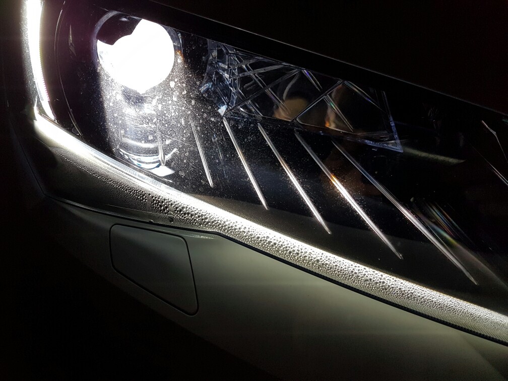

I have this issue on my Superb just along the bottom of both headlights where the running lights/indicators are. Just bought it, picked it up Friday morning so I guess it's been sitting around on the forecourt etc. I'll keep an eye on it but have attached photos in case anyone can tell me it shouldn't be this bad....
Mine was like that.  Took it back to the dealer who dried it out and although it still "fogs" occasionally it doesnt have the "droplets" any more.
Try silica gel sachets. It was suggested to me by another member and worked great on my fabia headlights.
Not sure whether you will be able to place them anywhere tho in those lights.
Thanks for this info. At the moment it has gone completely but it keeps reappearing in the mornings after cold nights. Will ask dealer to take a look when they have it in for fitting mud flaps.
