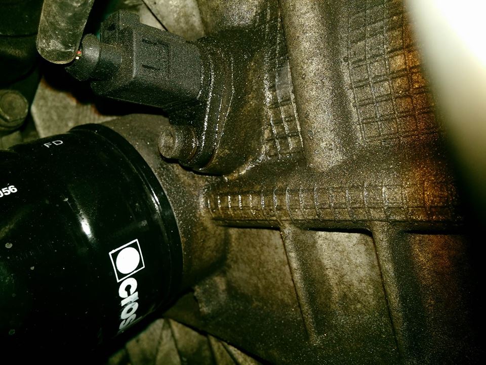

What is this?!?
Hi guys..I have a Fabia 1.4 mpi 2001.. today I found this oil leaking from this piece in the picture, I think that is the crankshaft sensor, does anyone know what is the product code and how to change it?
Many Thanks!

That's the camshaft sensor.
To change it you just remove the bolt and pull it out.
Thanks do you know the product code/ VAG n.? I haven't found it on the bay..
Thanks for the reply. Mine looks straight at the end, I have found one that is bended on the plug attachment.
That's a 16v camshaft sensor that is bent.
The engine is fine. I've just notice this leaking.
Wouldn't that be a crankshaft sensor in the block?

Just change the o-ring then. :)
Camshaft is in the block too.
Crank sensor is in the gearbox as it picks up off the flywheel.
I'll try the o ring first. The sensor is too much expensive.. :dull:
Do you recommend any particular product to clean this sensor from the oil? If the sensor is not working properly.. which problems can cause?

Definitely the camshaft sensor there, I've just replaced mine on my MPI. The part Wino suggested is the right one if you need the whole sensor, and yes it should stick straight out. They seem to be quite hard to get hold of on the aftermarket, mine was a genuine one, £35 from a Skoda dealer. My local motor factors could only supply the bent ones from a 16 valve, and I can confirm that the 16V one does NOT fit (I tried it!).
Techie is also right that this is not crank sensor, when you are looking under the bonnet and the cam one is straight in front of you, the crank one is off to the right side of the block, on top of the gearbox housing facing the sky, and is a flat design with a 45 degree slant to the wire connector.
