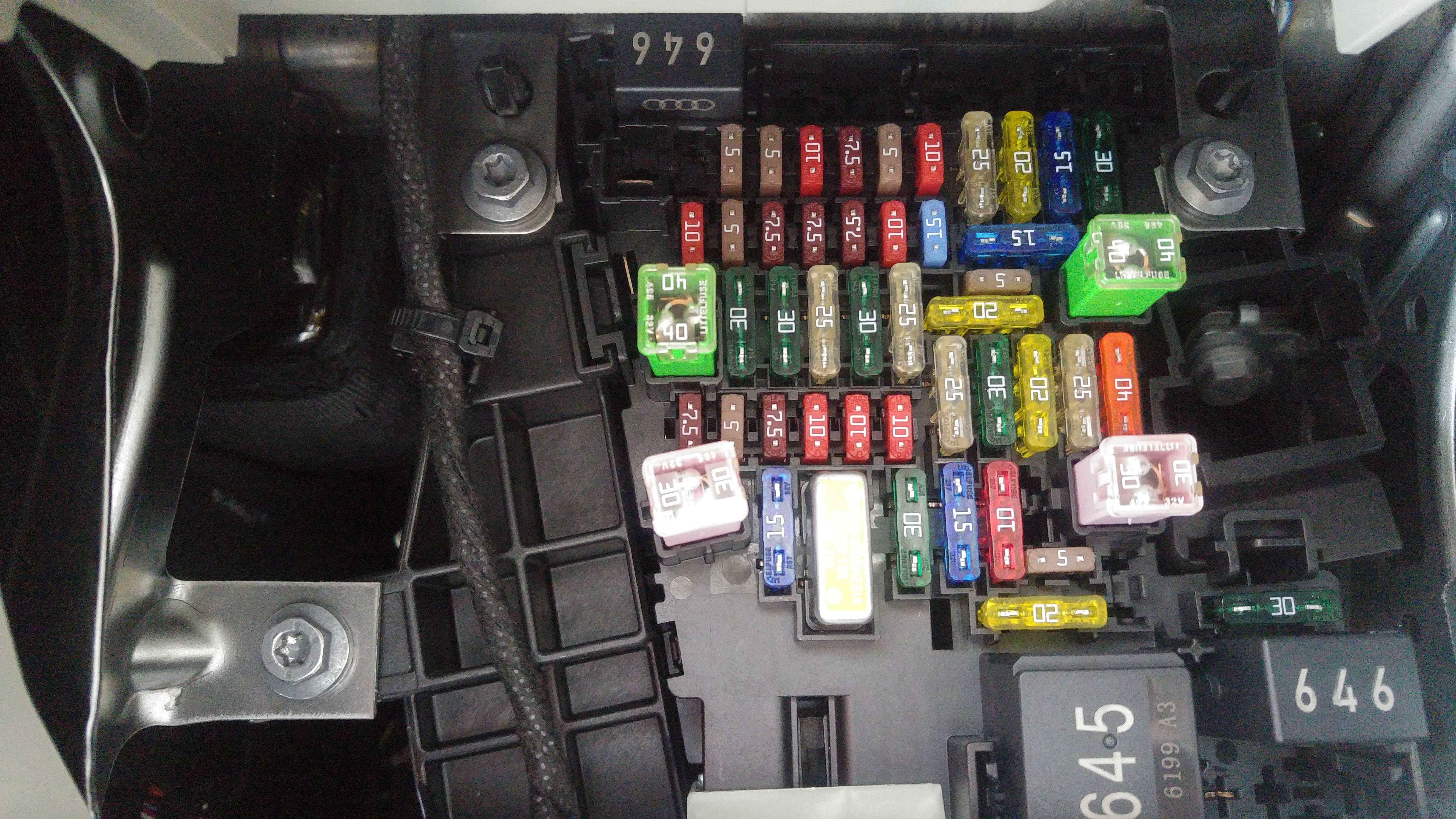

  • It's the one in the bottom row in the 9th picture and is the same one I used. It may be numbered 47 and definitely controls the blind spot detection. It's the only practical one that I could find as t

  • Great post with great pics but Which 10 amp fuse did you pull I have all the kit but not sure on which fuse to use.

Wondering if there is a better fuse position to use, that will maintain live while the ignition is switched on?
I used this position  (48 - Blind spot detection) and even start - stop  actively stops engine 30 sec. or more the camera have power and not interrupted.
Might be something wrong with your camera or the connections you have
Thanks for posting. I'm using 48 too. Will look into changing the fuse position to have a permanent ignition switched live.
My plan is to install a Raspberry Pi in place of the dashcam at somepoint so I get GPS overlay and more custom functionality. It will have battery backup, but the current start/stop issue, isn't desirable...
I don't know the fuse number but the red 10A fuse I used gives no problems with start stop active.

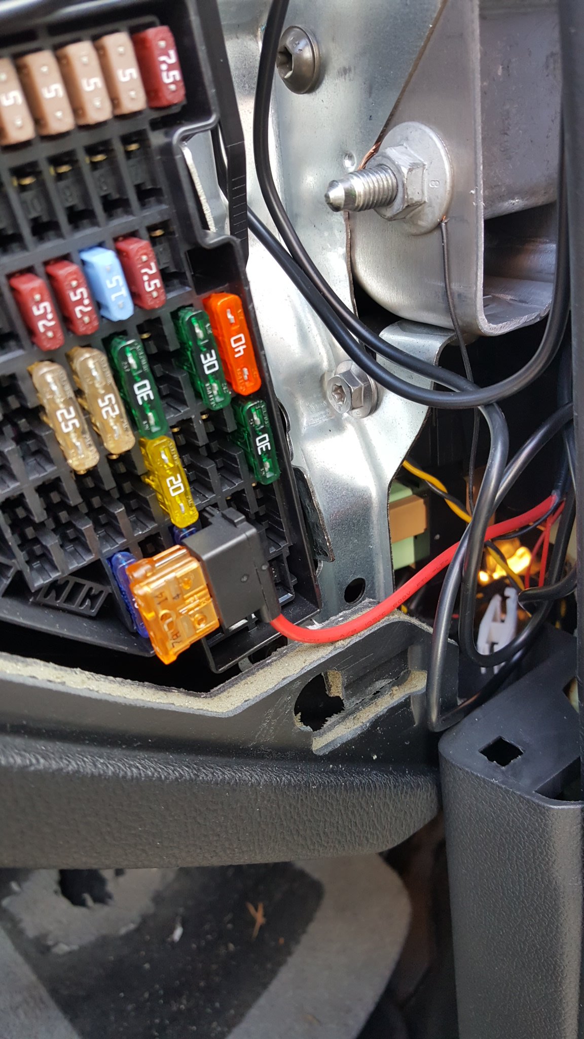

Here is the marked location for the piggy fuse i used.

There are also some micro fuses that are ignition live but i forgot which ones. i tested with a multimeter before installation but micro fuses dont have room around them so i used the 48 location.

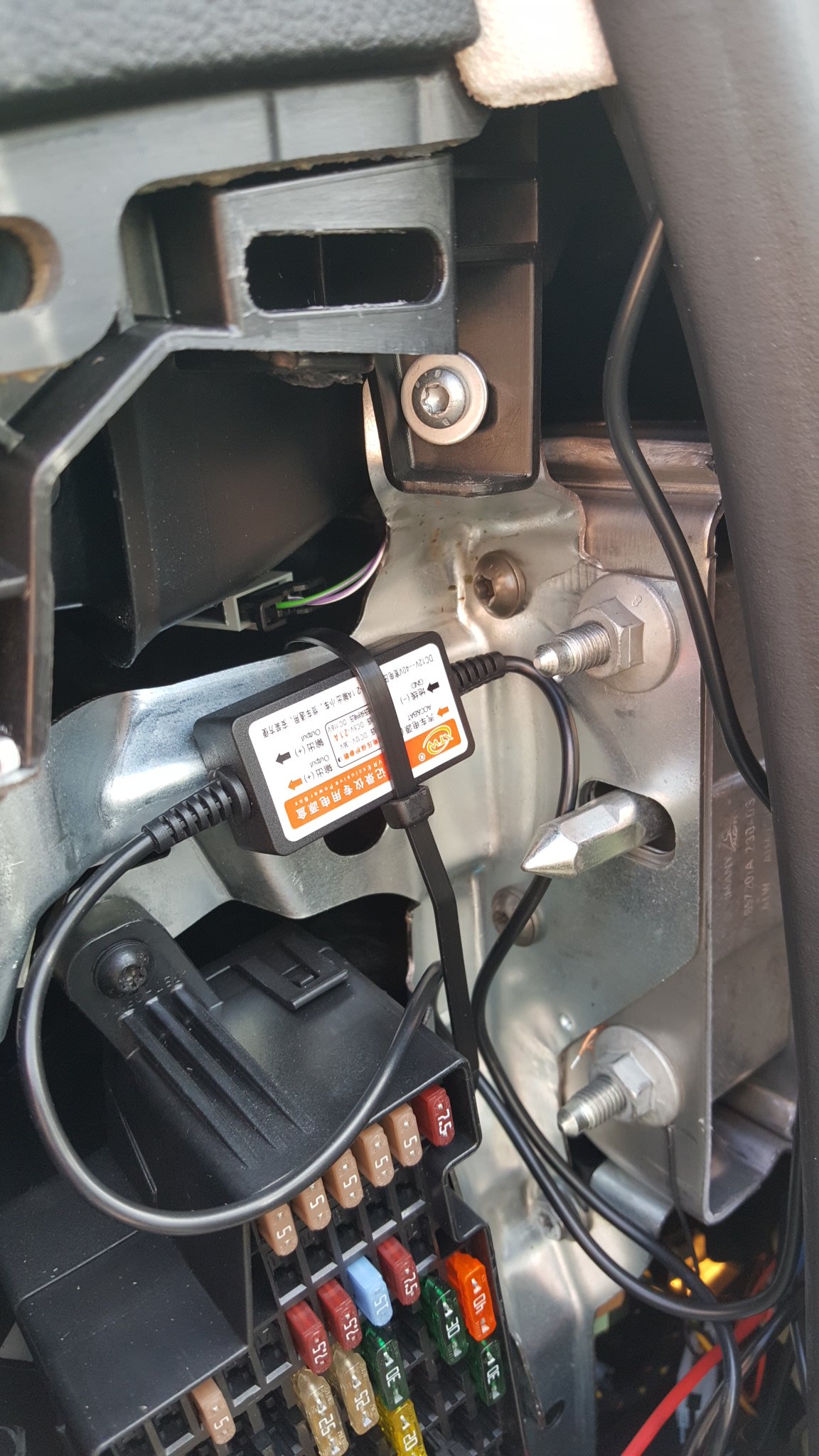

I needed an earth from somewhere and there was a torx screw under the lid that felt like it screwed into metal
Having looked at other threads on here (Thanks Gizmo) I knew the red 10A fuse was ignition switched. I tested it with the meter and also checked the screw was a good earth. Don't have enough hands to meter and take a picture.
Pulled the 10A fuse and plugged it into the piggy back unit that came with the hardwire kit then turned the ignition on - we have power.
Had a lot of excess wire so I just cable tied it and propped it in front of what I'm guessing is the pollen filter. It will flip out of the way if need be.

Hi, thanks for the response. I have since spent a few minutes with the circuit tester and went for the option above with the side dash panel removed - there are several bolts in that area, just need to loosen one and wrap the wire round it, then piggy back fuse holder. Using this area is also much neater - there is plenty of spare room for the spare cable and the cable goes straight in there from the side rubber door trim. I followed the 'OCD'  post above and have no cables visible between the camera and fuse box.

Any thoughts on where to connect to earth on a left hand drive S3?
Can I use any of those three clearly visible torx screws?
Yes any of those bolts that clearly go to the chassis (via the metal bracket) will be fine.
