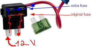

16 hours ago, MaddicIrl said:
It should be fine as long as you have the orientation of the piggy back fuse correct, the piggy back fuse will split the voltage into two circuits, one for the exiting circuit and one for the dash cam. The side that splits the voltage should be on the +12V side, it will work in either orientation but the wrong orientation will mean the current for both circuits go through the first fuse and then split. You may never notice or it may blow the first fuse when there is no fault (depends on total current and/or peak current of course).

2 hours ago, tigermad said:
How do you know what way round it is? I have removed it for the moment because the battery pack to it playing up but if I install on another car would like to know. Thanks.
I would remove the fuse from the piggy back holder that leads to the dashcam, a simple continuity test on a multimeter should show this. Place the piggyback holder with the original fuse in its slot and turn on the ignition (I am assuming you are using an ignition feed not a constant). Then use the multimeter on dc voltage setting to determine which side of the empty fuse holder shows +12V, thats the side of the fuse box which is supplying the voltage and the piggyback holder should be placed so the splitter side is on the 12V. Again a continuity test should identify the splitter side. When doing the continuity tests, remove both fuses and perform the test when not inserted.
You could do the same by simply removing the fuse and test but it will likely bring up errors on the dash, the above method keeps the original circuit intact so there should be no errors.
Mods can you delete the above post from me, plz. After thinking about it, the above method will not work, my apologies.
Alternative method, remove the main fuse from the piggyback fuse holder i.e. the one for the existing circuit, then place the piggyback in place, the correct orientation the dash cam will work, in the incorrect orientation it will not but this method may throw up errors which should clear when the main fuse is reinserted afaik.

39 minutes ago, tigermad said:
Ok thanks. My other fuse will be for the portable battery. My dash cam connects to the Cellink battery. Stupid question how do you know you are removing the main fuse. They are both 10a
i have just removed the whole system that was working for 2 years. My Cellink battery stopped working in parking mode and wouldnt provide a charge for anything. Plus my cars electric parking brake has started to play up to top the whole week off. Funny how the Cellink battery plays up and a couple of days later the parking brake comes up with errors every morning. Maybe my car has wrecked the Cellink somehow. Or might just be a coincidence.
On the one below, the bottom fuse is the one I referred to as the main fuse, the top fuse is for the accessory, in your case the Cellink battery. Also on the one below, the splitter side I referred to is on the left of picture. If you have a different piggyback type, a multimeter is the best bet, I can PM you how if needed.
