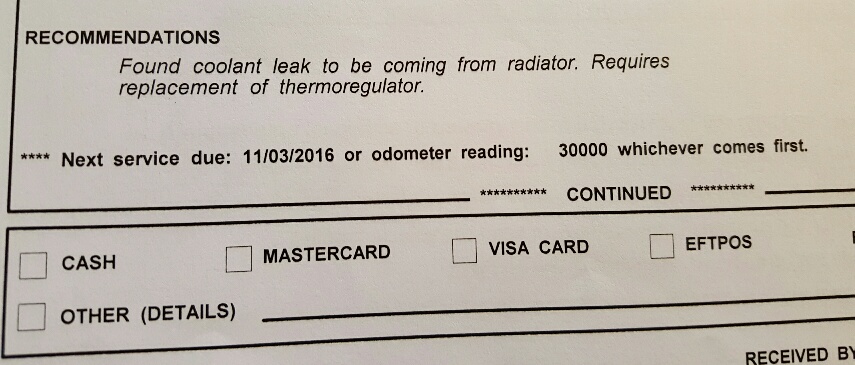

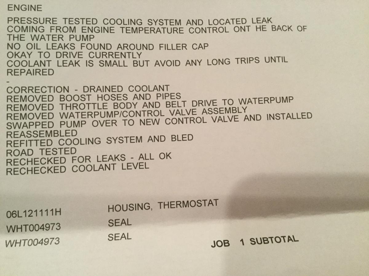

Thought this may be of use here for those losing coolant. My TSI was only losing slowly so no dramatic rear mist. Attached pic summarises events but essentially they replaced a couple of o-rings and thermostat. In addition, splashed coolant around the place, overfilled coolant passed max (coke can full) twice, scratched the speedo plastic face, all complimentary. Just another day in the life of a clown who likes to take care of his car.

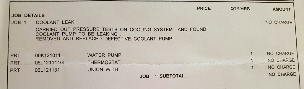

I had a slow coolant leak in my 2014 VRS from new.  I check under the bonnet each weekend so noticed it after a few thousand Kms.  Just before the 15,000km service I had the low coolant light come on.
This was their first diagnosis.
Then after the service they decided the water pump needed replacement.
After I got the car back it was leaking so bad I had to top up the water every day and it was leaving a puddle on the garage floor.  Took it back and they said the other pump needed to be replaced.  Apparently behind what they replaced the first time.
Long story short had a loan car for 3 weeks after that while they sorted it out.  All good now have not had to top up the water in the last 15,000km.
