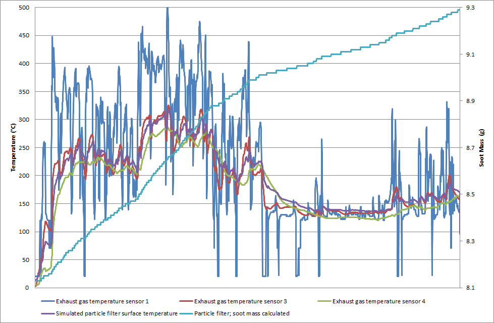

I logged the temperatures and calculated soot from my journey to work this morning as a reference for you.
This is an hours driving, you can see the A-roads, motorway and then town sections of my drive clearly from the EGT. There isn't any regen going on so I'll try and log my next few drives to catch that for you. However you can see the steady rise of calculated soot which is completely different to the 1g-26g jump you described.
Thx all. What program did you use to get this graph?

I used VCDS to create a CSV file containing the logs, I then used excel to open the CSV and convert it to a graph. I would expect any office suite (microsoft office, openoffice, libreoffice, google docs etc) should be able to produce something similar.
I didn't plot 'Particle filter; soot mass measured' as it barely changed, it was -0.3 at the start of the log and -0.29 at the end.

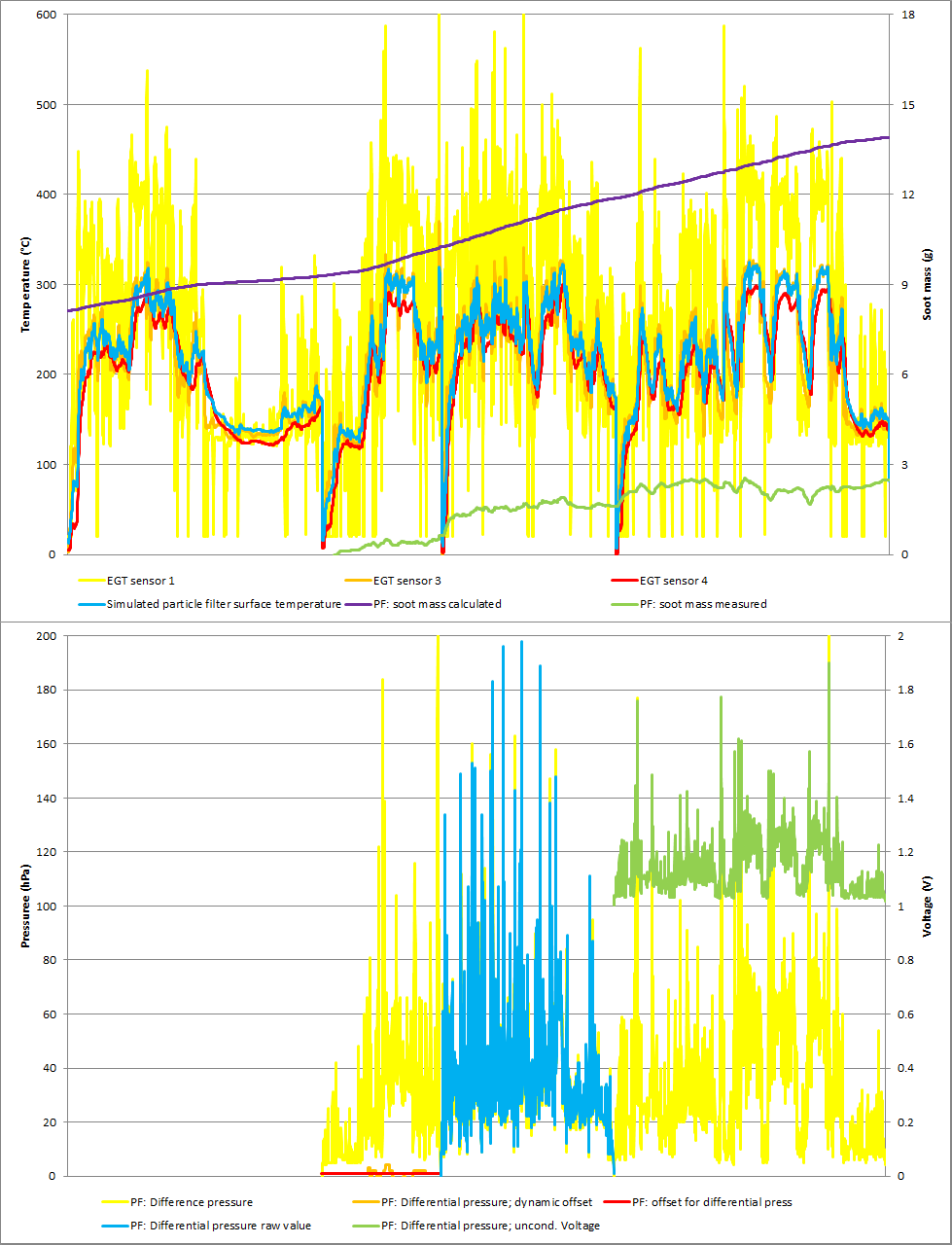

I've been logging various parameters for every drive I've done for the last few days.
- 'Particle filter; difference pressure' is around -1hPa before starting the engine and then anything up to 200hPa while running
- 'Particle filter; offset for differential press.' is always 1hPa
- 'Particle filter; differential pressure; dynamic offset' varies between -1hPa and 4hPa
- 'Particle filter differential press. sensor; uncond. voltage' is between 1000 and 1900 (I assume this is mV)
- Both measured and calculated soot mass are increasing as expected
I'm hoping to get enough soot mass for the car to attempt a regen as that'll give you a better idea of what normal should look like.
New graph attached:
