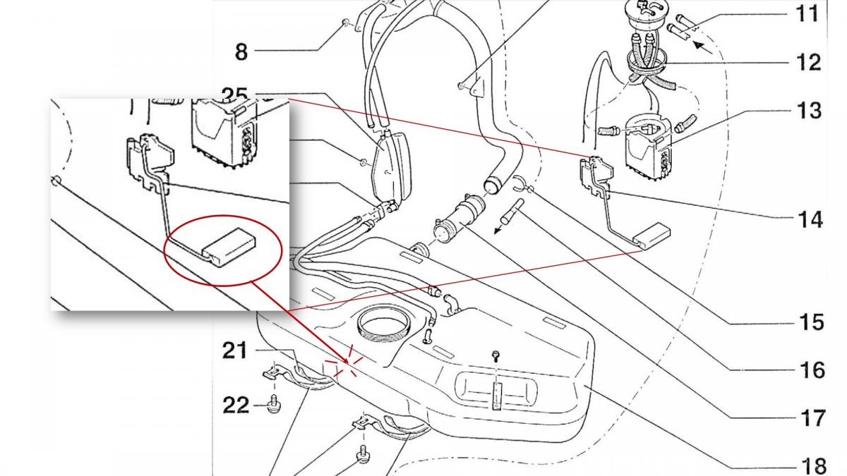

About the fuel sender arm: Skoda explained clearly what is the correct geometry of the arm (see photo). Furthermore, the arm myst be parallel with the longitudinal axis of the car (see other photo).

But according to this diagram, there is chances of hitting the wall of the tank with the float arm if it rotates along with the cap while refitting it. That's why Haines manual says that there is risk of bending the float arm.
The float (flange) must stay fixed in the correct position, not moving at all, while refitting the union nut. If not, you will hit the closest wall of the tank and bend the arm. It happened to me. Twice. Then I realized.
Edited by ObedP
You can't rotate the flange of the sender too much when mounting the plastic nut that holds it. The fuel hoses are very short and don't allow the rotation. You are either not explaining it right or you are talking about something totally different.
One thing is certain, if the fuel sender arm has the geometry showed in my previous post, it can't hit any part of the tank.
