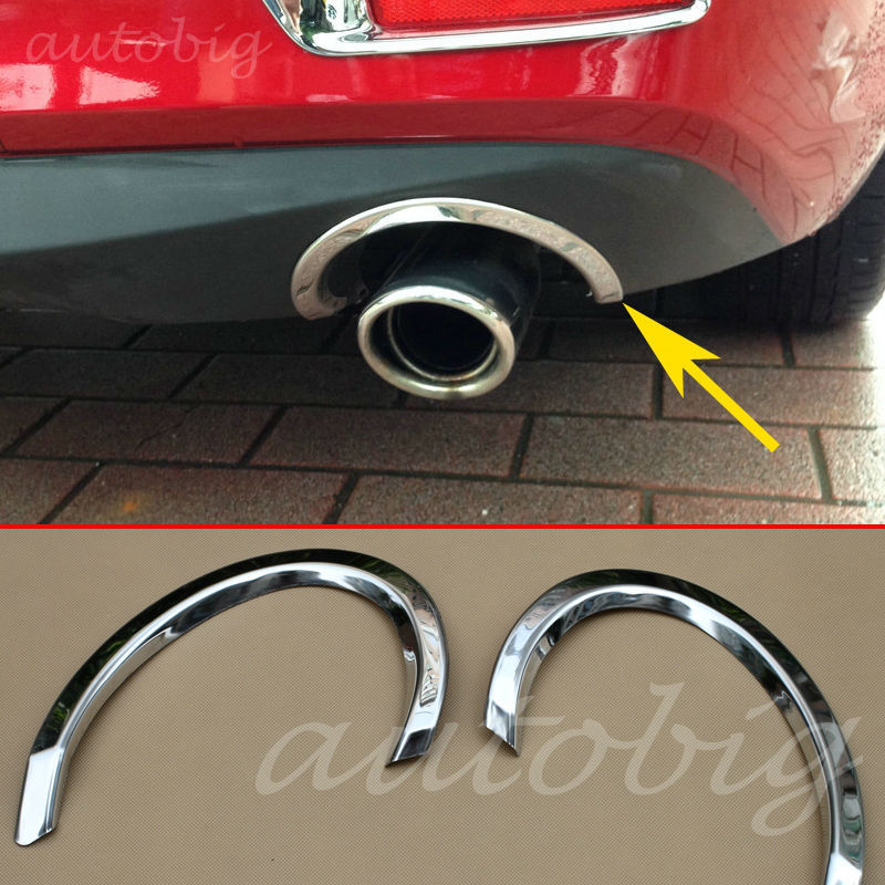

You get a Finisher for Tail Pipe Cut out areas that are a good fit around the Cut out on a vRS with vRS Standard rear twin pipes.
If you scope out one of those and try it next to a Valance on a Standard Mk2 vRS you know you are sorted.
The you have your template and finisher for the Monte,
just a case of trial fitting the vRS Back Box, getting the area right to cut, cut tight after being sure, and getting it then neat and Fitting
Back Box and then Valance Finisher.
Simple when said quickly.

I can not find the ones on a Fabia right now, but you will get the idea from these,
and i have a Kit / Motorsport Catalogue some place with them in.
*Merlin Motorsport* i think.

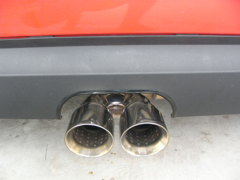

The one I got came with some trim to hide my shoddy bumper cut its meant for the fabia sport diffuser so not a perfect fit
Went and did it at the weekend, just took some careful planning and some elbow grease. I used a stanley knife and hacksaw after creating a template with masking tape and then used a dremmel to sand it down, then used a medium to fine sanding block and then fine to extra fine to get it smooth

It was in pretty good condition when i got it but i did put in a bit of graft with a wire brush and sand paper and some bras polish so it does look pretty shiny
