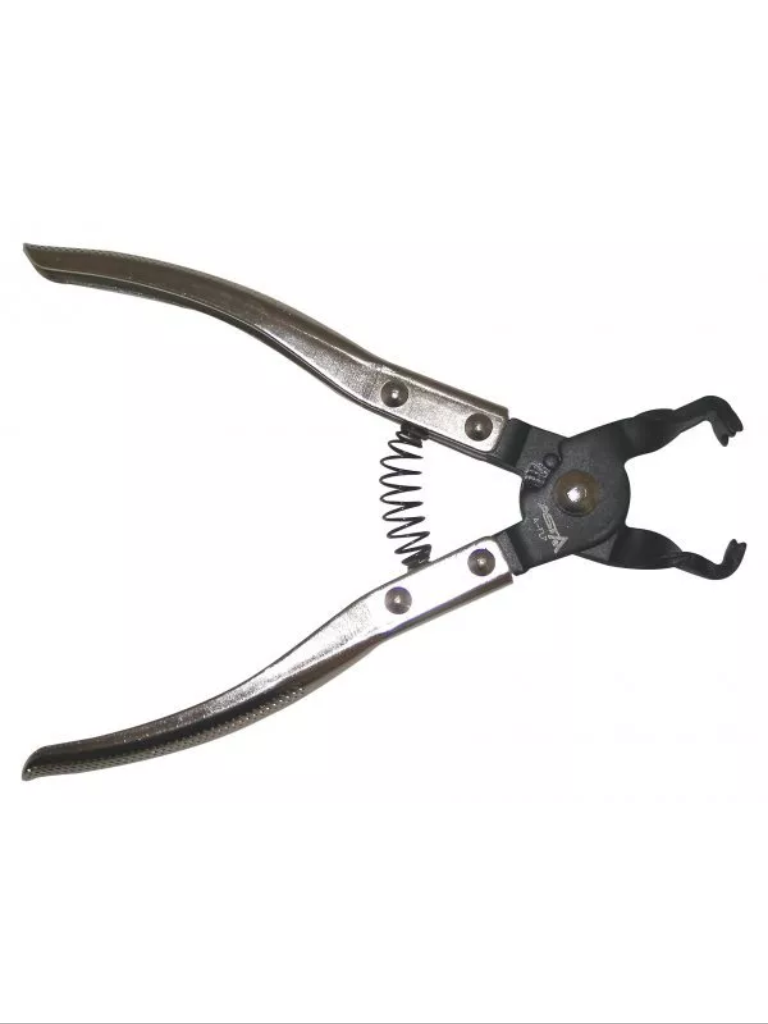

If you are really stuck, you can get special fuel clip pliers from the likes of machine mart etc that can offer a better purchase. Purchase of the pliers has got to be a better first option than the aggro you will encounter fitting a new fuel line

Hi guys are these said pliers

They look very similar to my Sealey pliers -     http://www.sealey.co.uk/PLPageBuilder.asp?x=0&y=0&productdescription=fuel+line+pliers&pageindex=1&gotonode=DoProductSearch&method=mProductSearch&IndividualTypeID=&category=0&requiredresults=16 , so should be ok, unless there is something that the picture does not show.
