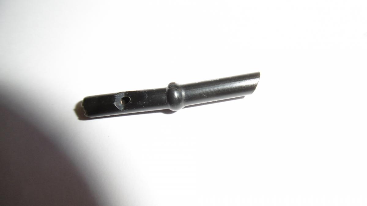

However on the 1.9 pd the egr, turbo variable vanes and anti-shudder valve are vacuum operated and if there is anything wrong/leaking with this system including associated solenoids then you can have errors thrown up on any of these systems and it's easy to start replacing expensive parts when it's just a simple leak
The flexible pipes can rot or rub through and the hard plastic pipes can eventually run through with the diesel vibration. The vacuum system starts with a "T" off near the brake servo which takes a feed from the larger brake servo pipes to the very small pipes feeding the above systems. I did this on mine , disconnecting at each stage to feel/listen for the vacuum - mine was a rubbed through hard plastic pipe - see photo of small section cut out with hole rubbed through:-
