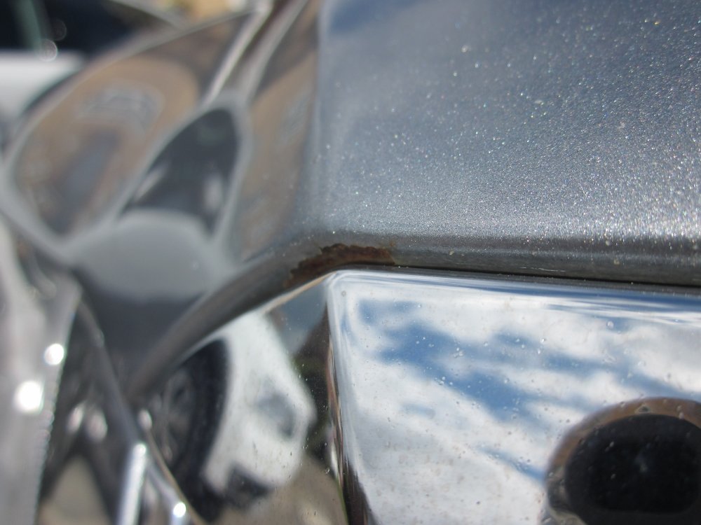

Does this rust qualify for the Body Protection Warranty?
I think I know the answer but just after a quick consensus.
The car works hard covering 30,000 miles a year, I'm not meticulous with washing the car but do keep on top of it every three or four weeks.
Doing the mileage I do means the car picks up it's fair share of stone chips which I always touch-up as soon as they are spotted.
However when washing the car today I noticed quite a large patch of corrosion in between the grill and the leading edge of the bonnet. Thinking this must be a stone chip I've somehow missed I was a little annoyed, but then I spotted that there is exactly the same patch of rust in the same place on the other side of the grill. Looking closer it seems to me as though the grill has been rubbing against the bonnet.
This to me then seems to be either a design or manufacturing issue rather than something I have done?
The car is getting on a bit now at 5 years old (2011) and 96,000 miles, although it does have a full main dealer service history.
Checking out Skoda's policy then the 12 year bodywork warranty is quite specific where it says:
"All new ŠKODA vehicles are fully protected during manufacture against corrosion emanating from inside the body panel for 12 years from the date of first registration."
This damage has not emanated from inside the body panel so I'm guessing this is not covered.
Anyhow, here it is, any thoughts?

I think you are right as to the answer, although you could try the "it is rubbing against the grille" as a defence. I will look at mine tomorrow though I am sure it hasn't effected mine. Fingers crossed, touch wood.
I don't remember where I read it but when I was looking at buying my used superb I found a list of things to look out for. Rust at this location was one of them so must be a known issue I guess.
Found it!
http://www.briskoda.net/forums/topic/235068-skoda-superb-ii-known-faults/
Seems to be a known issue.
As suspected it has to be claimed on the paint warranty, which unfortunately is only 3 years so I'm well over.

Yeah, it isn't perforated, it is merely surface rust, however given it's location it'll soon spread. It wasn't there during the cars last wash four weeks ago.
It's worth a shot so I've fired off an email to Skoda UK. No doubt they'll ask me to show it to a dealer, after which it'll get rejected but it does appear to be manufacturing / design fault.

I have corrosion at the exact same location on my 2011 superb. Would be nice to know how this unfolds.
The car was inspected yesterday at Pulman Skoda in Durham. Photo's taken and a report sent to Skoda UK.
It's a waiting game now.
Great news. :)
Score! Well done.
I was surprised, especially on a 5 year old 100,000 mile car.

Booked in for a respray on Tuesday 5th July!
Skoda UK have been excellent, pushing the dealer at every turn.
All sorted, the car was picked up this morning and taken back to the dealer. As it happens it looks like they carried out a smart repair rather than taking it into an approved bodyshop.
Still the work looks good, the grill was taken off, rust removed and repainted and still covered by Skoda's warranty.
I also asked for a quote to have a few other little scuffs and scrapes fixed whilst he was at it, £90 and the car looks like new.
