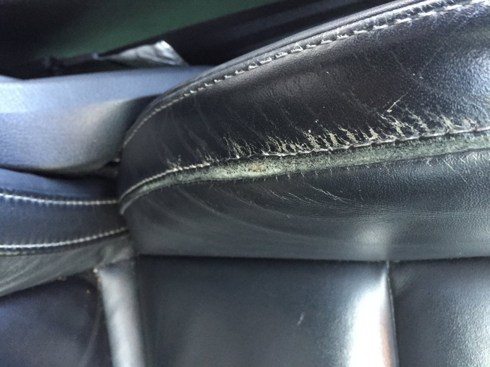

  • If you are buying a second hand Elegance check the door side bolster of the leather driver’s seat, they wear into holes very quickly. Skoda will replace the seat cover if it is still in warranty.
This has been added to the list, thanks a lot. :-)
