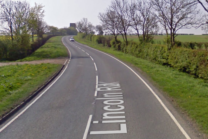

I have the 220TSI DSG box and have to say at the moment I prefer driving in manual mode as it does not seem keen to change up and when it does it will change down for the slightest reason.  On my commute to work, 50MPH, there is a climb that the car is forever changing from 6th into 5th and sending the revs over 2000.  Driving in manual and forcing it to stay in 6th the car drives up with no problems - slight increase on the throttle and the engine cruises up..  Attached is a screen capture from Google showing this climb.
Is this the norm for the DSG, or will it improve in time.

Hi Derv
No it is dropping the gear and raising the revs.  Have had the maxidot on the average MPG and it drops like a stone as does any form of acceleration I notice.
Hi Derv
Sorry mate I think I explained myself badly. I did realise it was dropping a cog and raising rpms, I was just wondering whether it was saving fuel overall (i.e. less throttle required, and the engine being considered as labouring in 6th, hence the switch). You're probably just on the border of shift points in the box's map. Try adding a couple of MPH (or dropping a couple off, if you'd prefer) and seeing if the box behaves more consistently (i.e. staying in 5th or 6th instead of switching back and forth).
I know what you mean, the speed limit on the road is 50MPH which on this engine as you know is barely 2000RPM so I guess you could be right that I am on the border.  When in D I do find myself using the paddles and changing up as the car seems to take forever to do it (circa 1700RPM)
