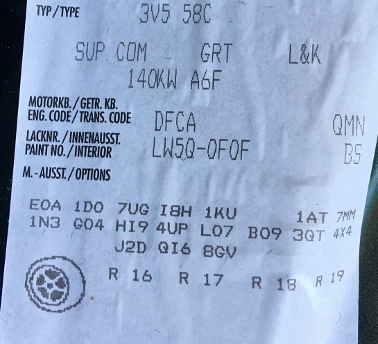

Did you get your codes from the build sticker in the boot?
My build sticker doesn't list that much on it. Doesn't even list things like the SLA or ventilated seats, even though they are quite obviously there!
No, I have a PDF supplied by a contact who has access to ETOS.
Ah right. Was that via the VIN or something?
yeah it was.
yeah it was.
Ok, thanks. I know someone who has access to that system. I'll get my VIN over to them and see what's what. Given what I found in the fuse box this morning, there must be some sort of electrical aux heating on board.
