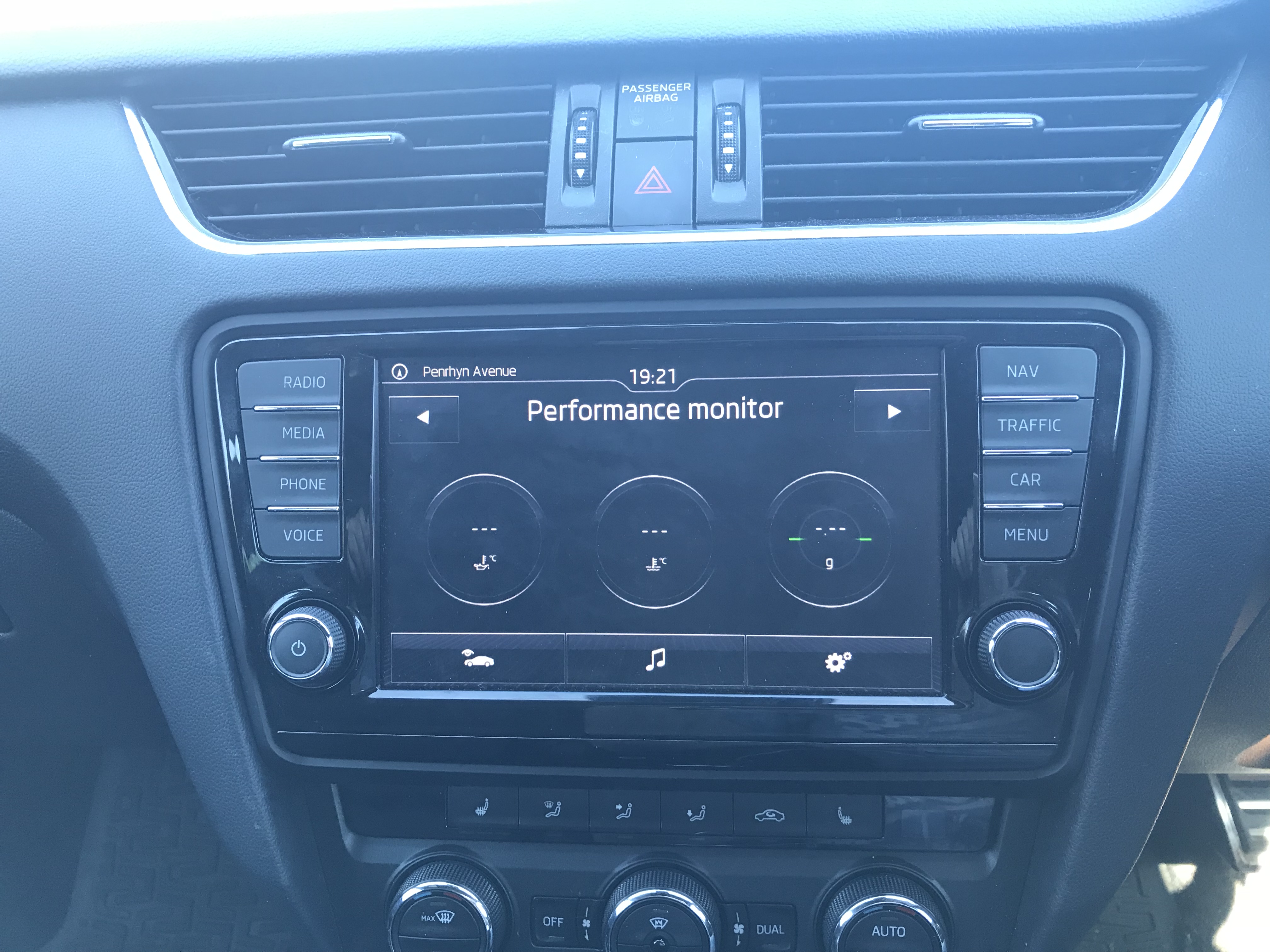

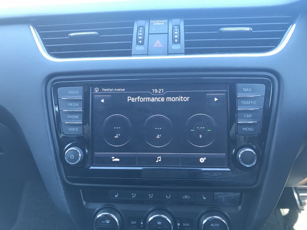

As linked above, Pab567 activated the display in my car just because it’s something else for it to have, so might as well. It’s cool, but tbh I never use it. If you really want it, might be worth dropping him a line, but it’s probably not worth it IMO. I had mine added while my radio was with him for other coding so it was a ‘free’ extra if you like that I wasn’t paying for. Here it is on my car.
Egine is off, so nothing is working, it does work with the engine on :)
can it record 0-60 times?
No, if it could do that it’d be cool! It has those 3 gauges and a lap timer, but you can activate a lap timer in the Maxidot anyway. There is a ‘display acceleration’ tab in the Instrument cluster settings accessed on VCDS/OBDEleven, but I ticked it and it didn’t do anything.
