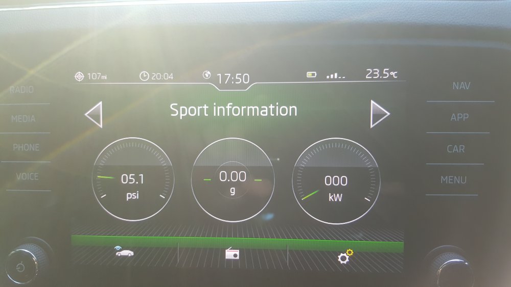

Had this on my 2017 golf match edition 1.6tdi and it was on the superb sportline I test drove last week. Nice little gimmick. What it does highlight is that when the car is in eco mode you don't get full power, only 85%ish, but when you press the throttle into the kickdown it then gives the full power.
Its standard on the vRS245

I wonder if it's just on the 245 but not the 230. What's the navigation path on the infotainment that you follow?
Yeah as far as I know, its 245 only in the Skoda range, it's found under Car menu, then Lap timer, then side arrow
