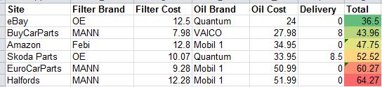

I was just thinking of doing an oil change myself this weekend or next. I have been looking around at prices too.
I thought I would give the forum a search instead of starting a new thread.
fleaBay was the best.
Filter: http://www.ebay.co.uk/itm/Audi-A3-A4-A5-A6-A8-Q3-Q5-TT-genuine-oil-filter-06J115403Q-06J115403J-/182129821172?hash=item2a67c885f4:g:hXYAAOSwuTxV9rCB
Oil: http://www.ebay.co.uk/itm/Quantum-Longlife-3-5W-30-Fully-Synthetic-Engine-Oil-5-Litre-Bottle-EXPRESS-/172180841695?hash=item2816c724df:g:Cx0AAOSwJkJWl8iL
Quickly did a search of filter/oils across a range of popular sites:
