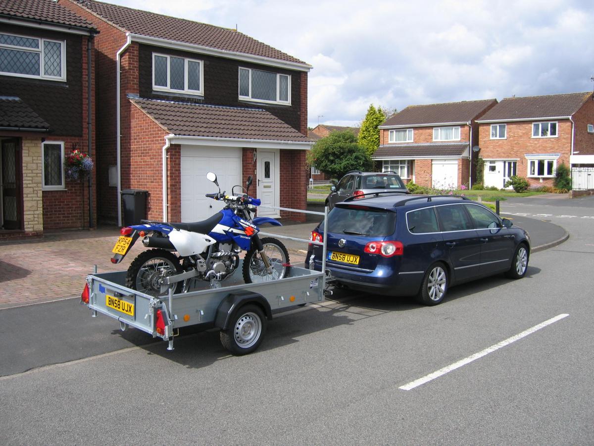

I bought an Ifor Williams P7e which I've used for collecting DIY materials; plasterboard, doors, son's 3 piece suite etc. and my trail bike and for those purposes it has been great and it's a proper mans trailer!
