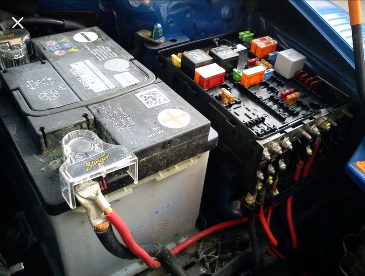

Red lead from battery i think goes to the plate on fuse box. Make sure thats clean at battery end if you have no power to the metal strip. All the top conectors should have 12 v and below the fuses should be 12 v unless blown the 0v
The top connectors being the bolts? (Sorry, lol)
Yes pal

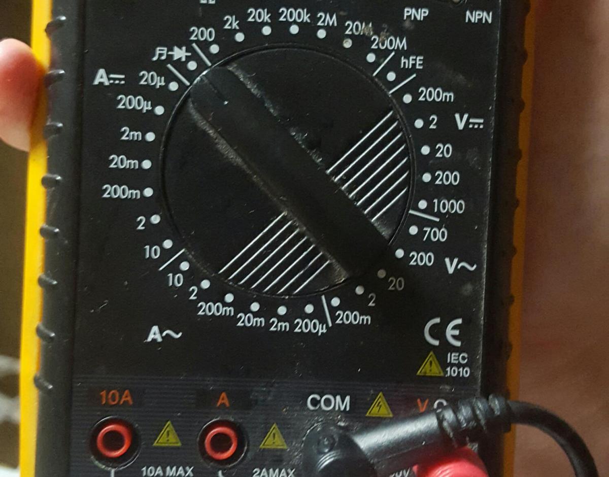

I used a multi meter with a continuity beep feature all fuses beeped. So Seems if I have tested the fuses correctly they're all working.
What's the next thing I should try? Before spending a fortune on a mobile mechanic?
Attached is multimeter setting used.
Edited by mikeSUFC
Check your messages
Set it to the 20. Around the 3 oclock area
That is not really the way to test the fuse when there is the possibility of a voltage being present. A continuity tester can respond to the voltage present and give a false beep. That said, if the fuses are intact it will give the correct response.
Switch your meter to the 20V range and then 1) measure from ground to each end of the fuse and then 2) measure the voltage across each fuse in turn.
With a good fuse test 2) will show zero volts. Test 1) should show the same voltage at each end of the fuse. A blown fuse should show battery voltage at the feed end and zero at the other end BUT sneak paths from the load can still show battery voltage as the resistance presented by the meter is very high. That's why you need to do both tests.
Chances are that your fuses are ok but putting the voltmeter across the fuse will confirm it.
Incidentally, using your multimeter on ohms or continuity beep when a voltage is present can at best blow its fuse or at worst, damage your meter.
