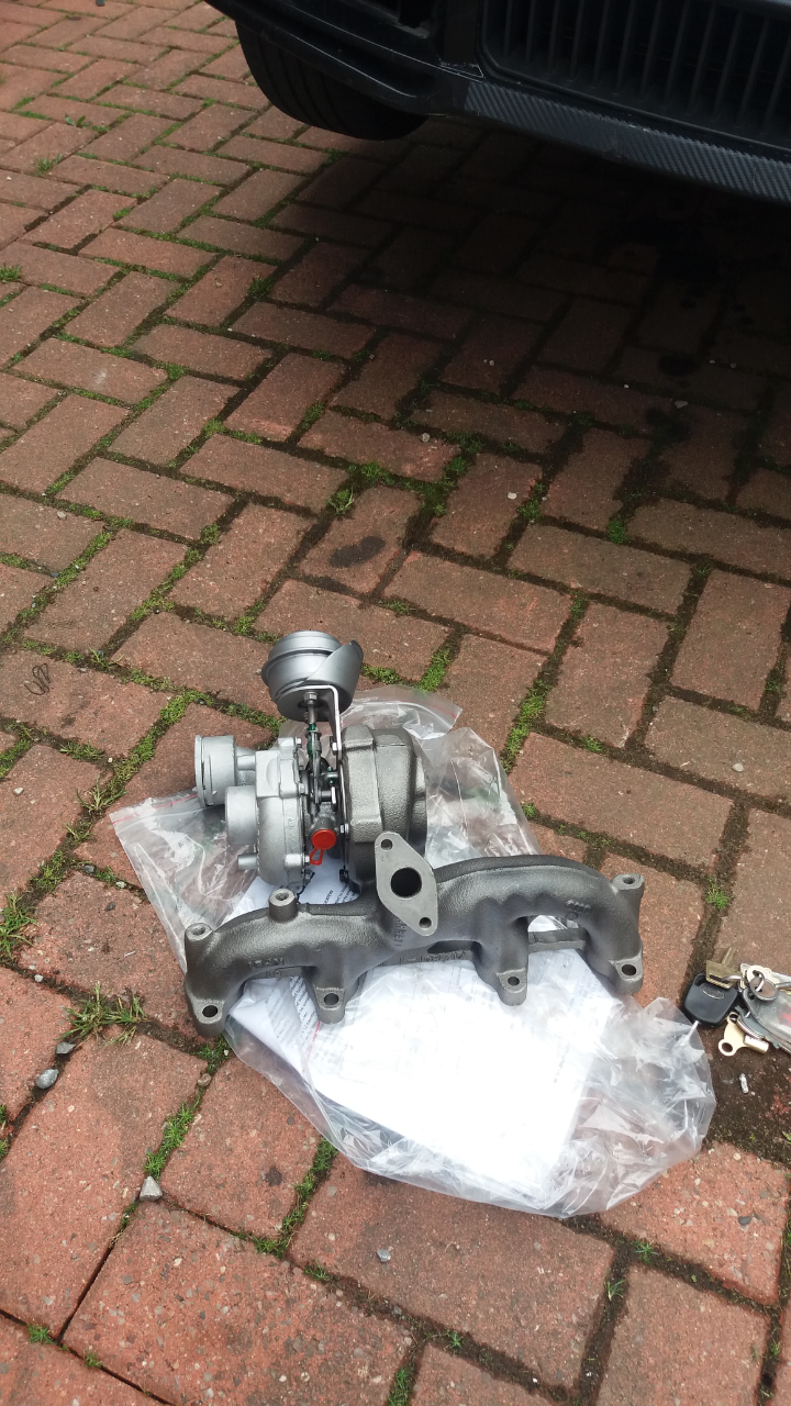

Anyway all sorted, New hybrid pd160 turbo

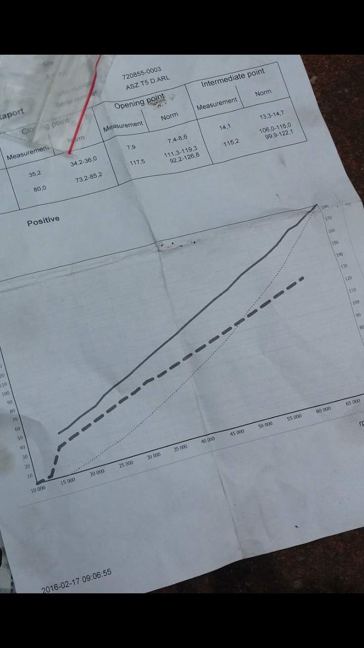

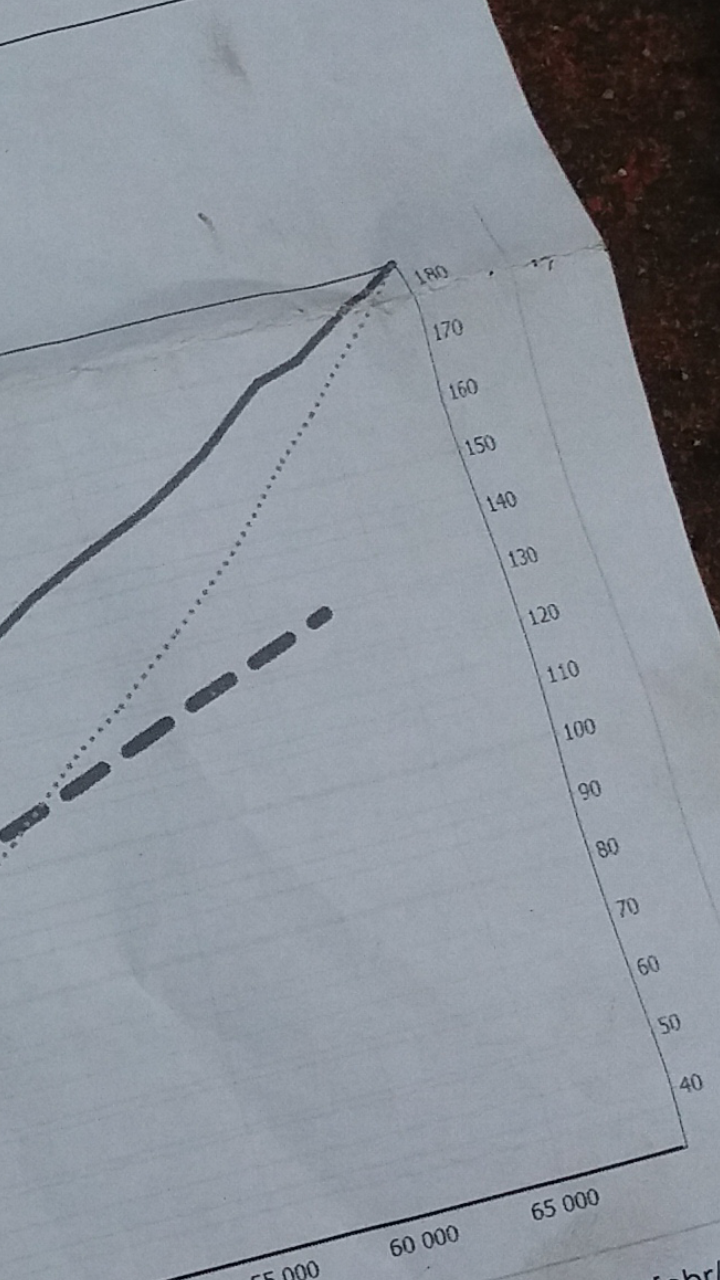

Bench test results
hmm hows this compare to the usual 150?
From what I can see online theres no real difference. Might be wrong though
I guess if it's a hybrid it will come down to whatever company that made it has put into it.
