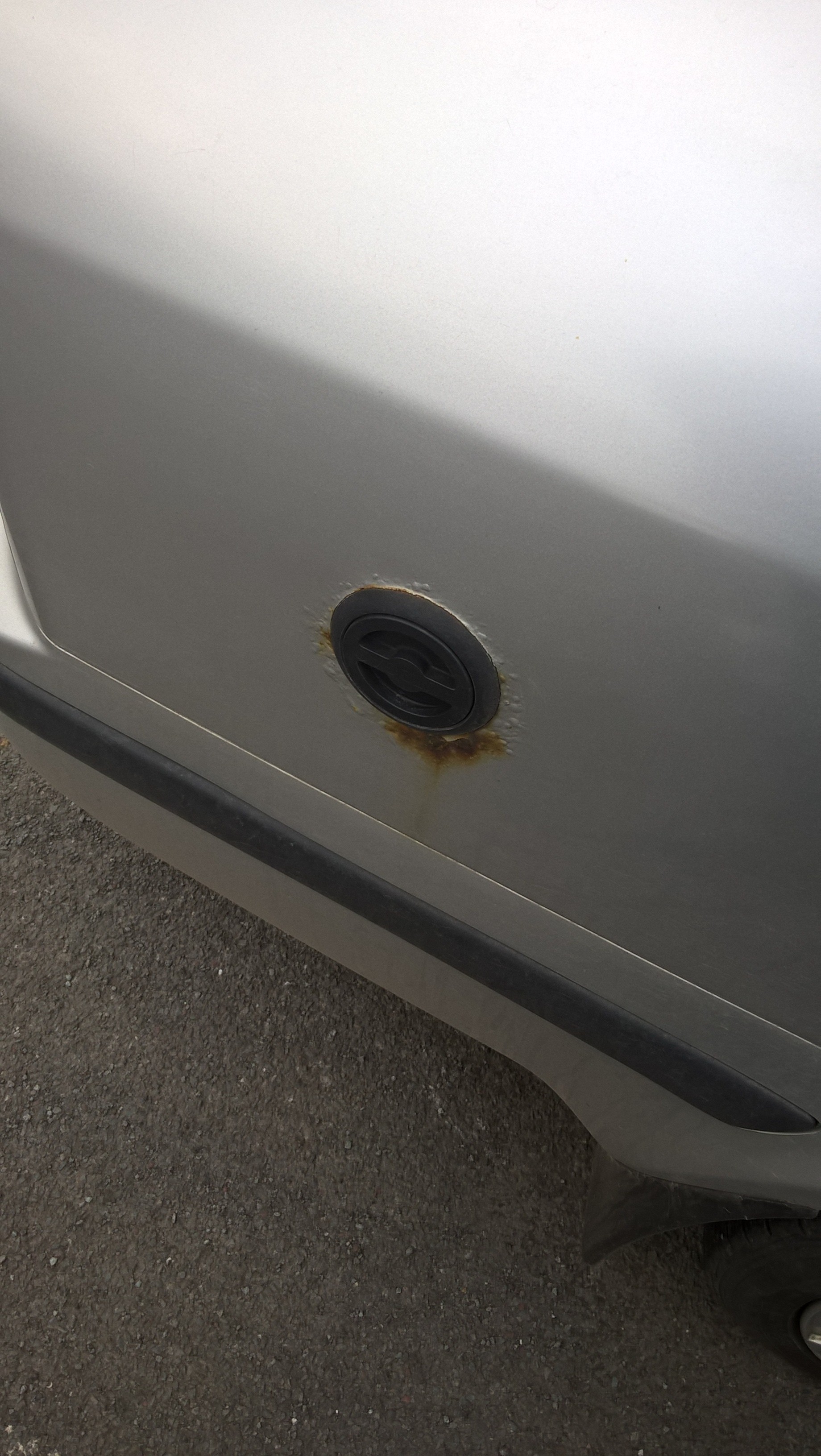

The downside is the bodywork needs some fettling, there is some surface rust at the front of the rear arches, and the underseal has been damaged where it has been jacked under the sills, but the worst is round the LPG filler hole, where it has been done before.

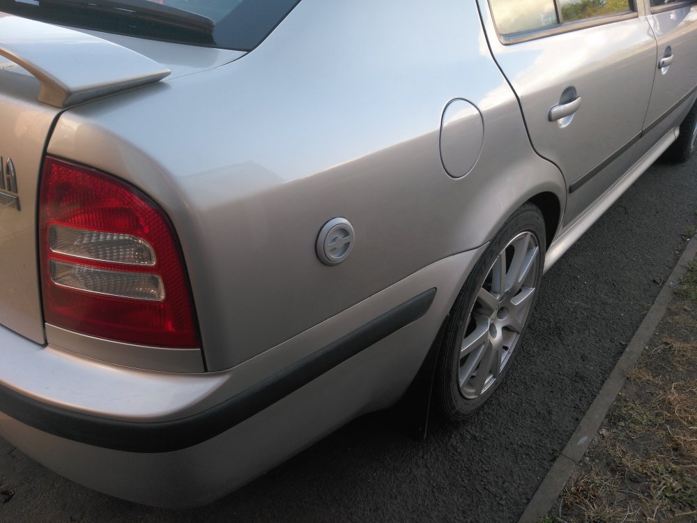

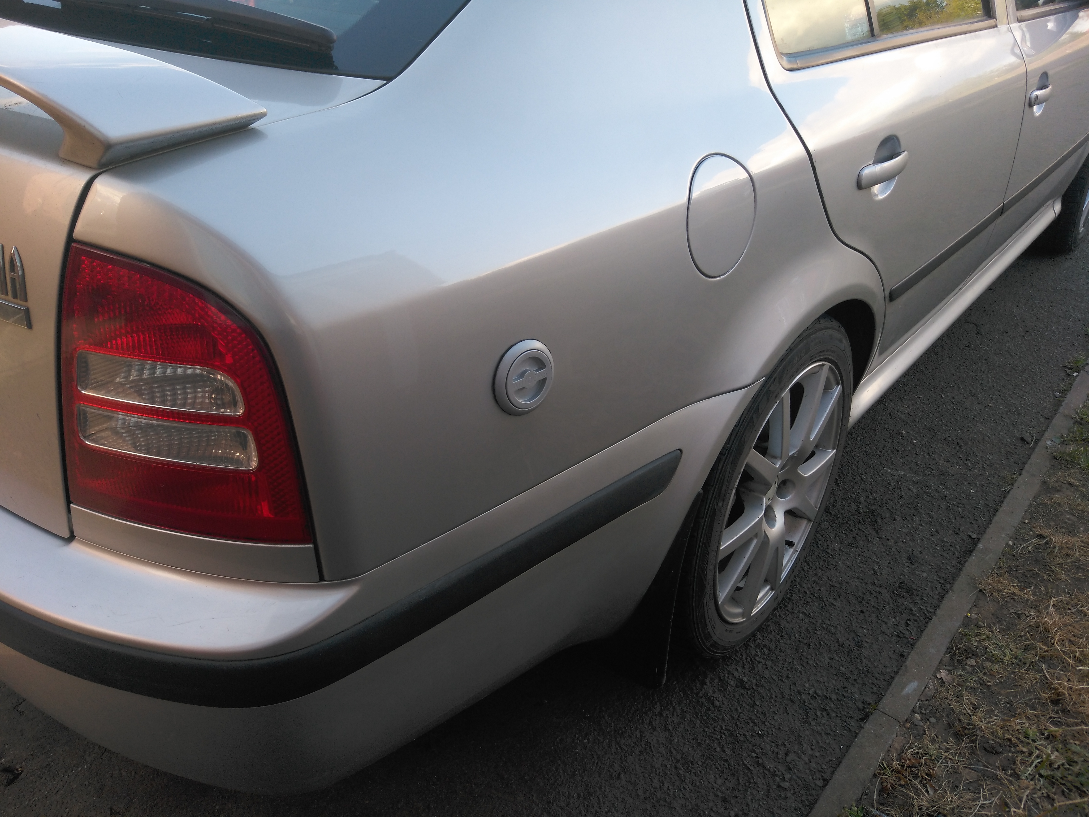

Firstly, managed to get a good price to have the rust around the LPG filler sorted after Easter, so went from this
to this

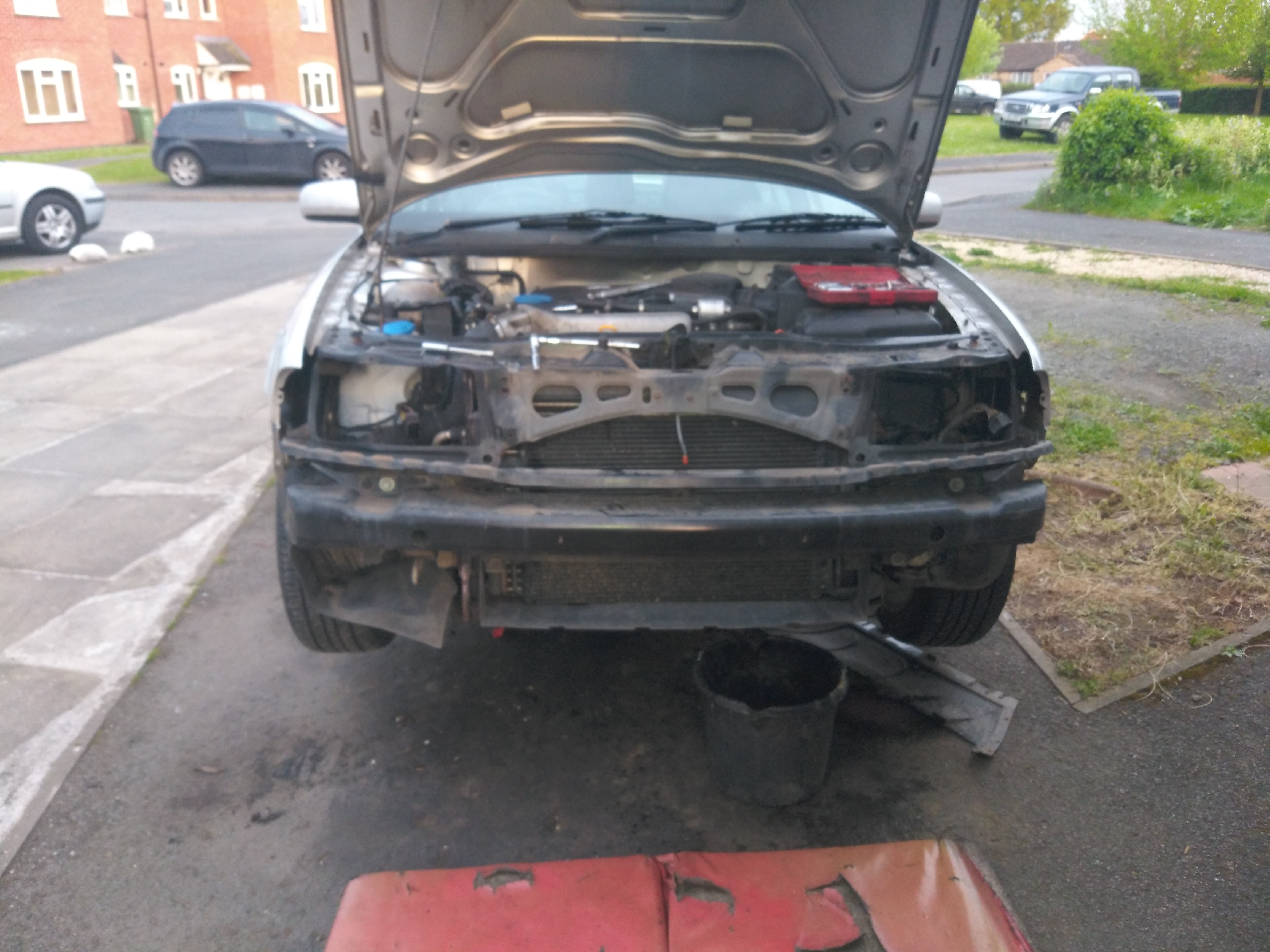

Sorted a cambelt kit and waterpump from work, thinking the pump had sprung a leak. It was supposedly changed 3 years ago by the previous owner, got it all apart, and it was the original water pump - only thing is, it wasn't leaking????
Anyway, managed to track it down to a split in the end tank of the radiator (which was replaced just under 2 years ago due to age). Fortunately GSF had a bank holiday deal on with 55% off, so bagged a new radiator for £40 delivered, and 3 litres of proper spec coolant for £12 delivered - result.
At this point I realised it wasn't going to be a 5 minute job to change the rad.........
Total of nearly 3 hours - fortunately nothing was seized and nothing broke!

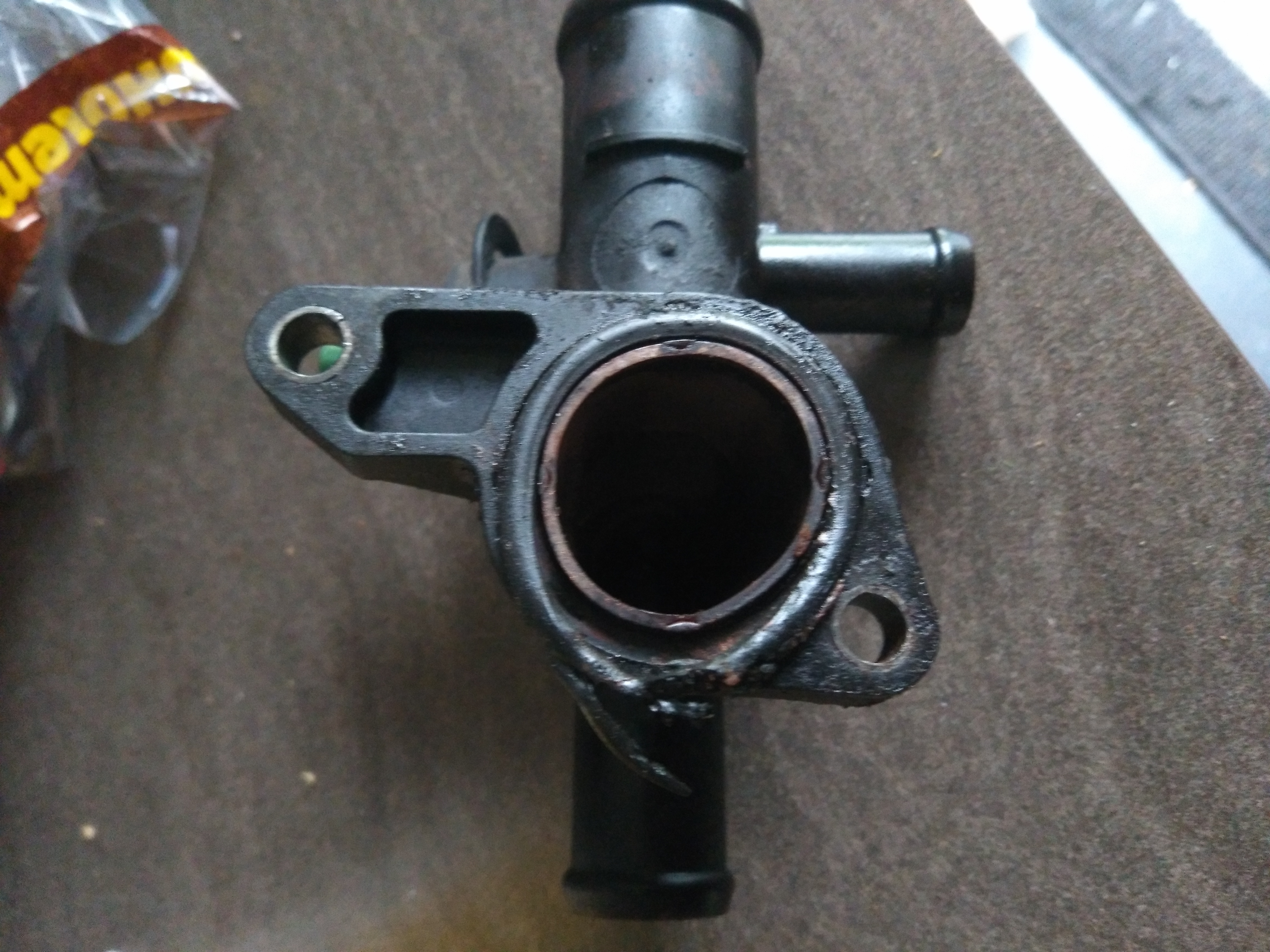

I am sure the cooling system on this car is cursed - or she is just getting incontinent in her old age, lol. Two weeks ago I noticed the low coolant warning flicked on, checked the level and it was low. Had a poke around the engine bay (remember further up my fun and games with the radiator....) and spotted that the top of the gearbox was wet, along with the pipe where they had spliced the LPG vaporiser in with a metal pipe joiner. Easy job I think, remove the jubilee clips, clean up the pipe and re assemble - yeah right! Next day, check the level, and it has dropped again, dammit. Topped back up, still wet on the gearbox, so remove pipe again, re clean and wrap with multiple layers of insulation tape over the join and redo the jubilee clips again (I have used the tape method to great effect as a stop gap repair). Two days later, light back again!!!  Upon closer inspection I noticed water leaking from the 3 way coolant flange on the end of the head - bingo!!!
Anyway, stripped it all down, managed to knacker the vacuum lines a bit more (new kit on order for that), and found the O ring had perished, new one from local TPS for £3.60 (half the price of the entire unit off ebay!) and job done - except the damn link pipe is still leaking, so need to sort that out now, hopefully for the last time this weekend.
