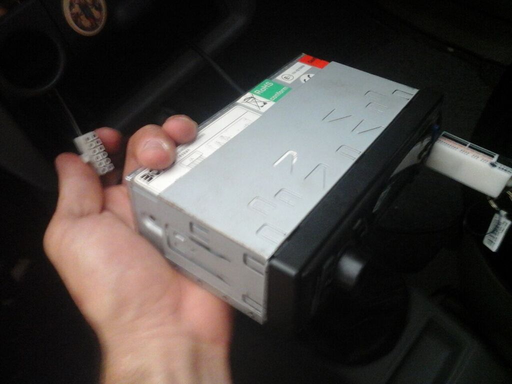

3.now remove the radio and any additional wiring to it including the aerial feed to it.post-114994-0-51384400-1464369428_thumb.jpg

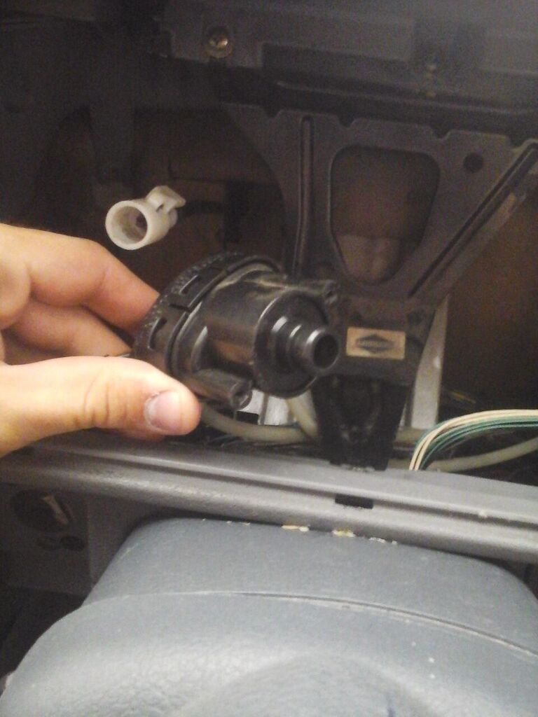

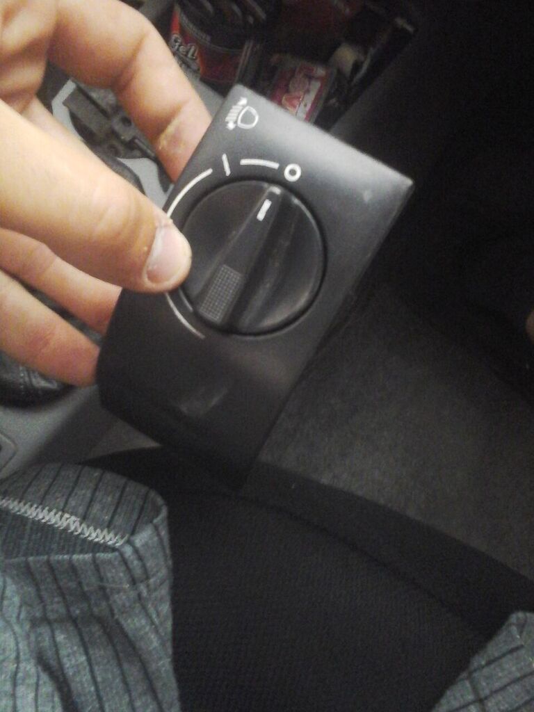

6.remove the headlight beam adjuster assembly from the left of the steering coloumn taking care of the plastic as it easily breaks if you force it.

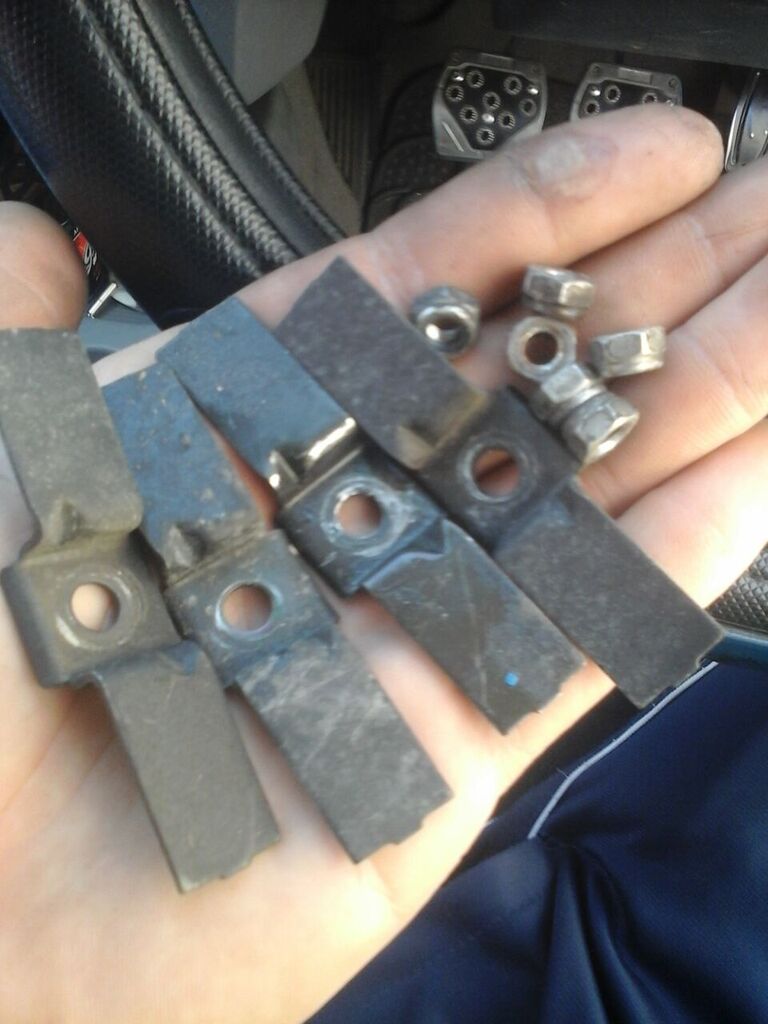

10.now there are 6 bolts in the engine bay, 2 lower ones which are located on each side and 4 upper ones with the insulation plates. they can be pretty hard to remove and if the nut keeps unscrewing and doesnt loosen up like mine did. get a pair of pliers and hold the bolt from behind.

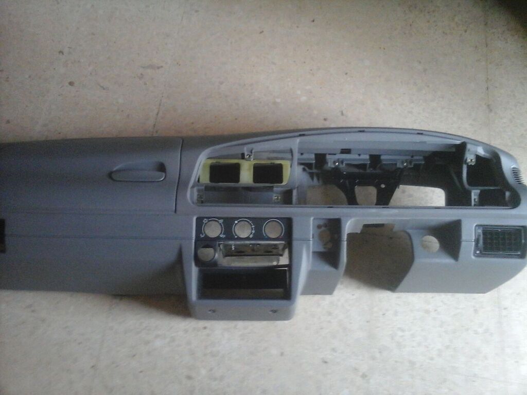

11. now all you have to do is remove the whole dashboard by pulling on it. it will be a bit hard at first, but it will come out.

Supporting illustration for step 7
Supporting illustration for step 8
Supporting illustration for step 10

Speaking of my photos, here are just a few that might make a difference.

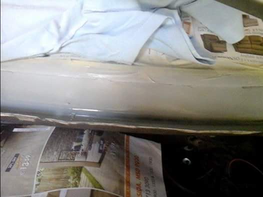

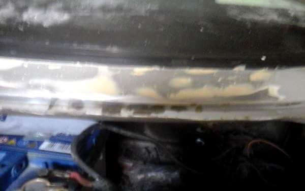

Thanks, that was my purpose too of removing the dashboard. Prepare for a massacre of rust because thats what was the case with mine.
post-114994-0-62447200-1464445768_thumb.jpgpost-114994-0-67361000-1464445792_thumb.jpg
I had a massive hole of rust i fiber filled it and primed it and sealed it. And i also primed and sealed it from the inside
