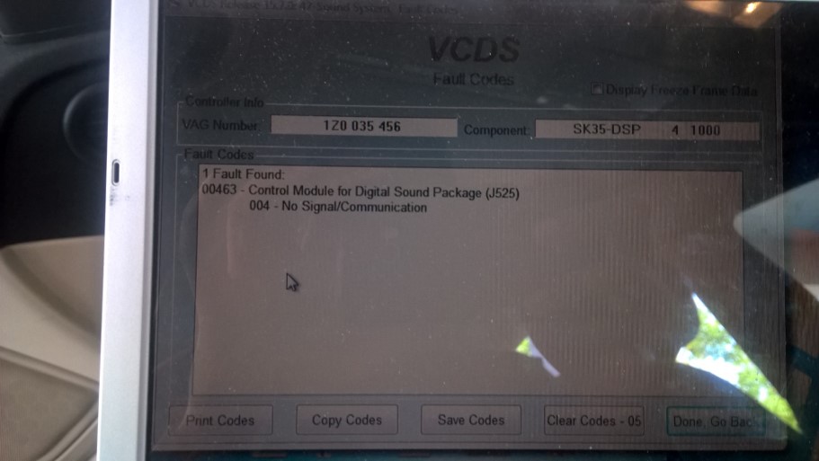

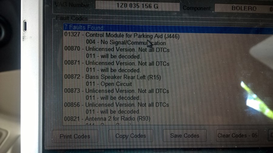

I have a pre facelift Octavia 2008 with amplifier. I replaced the audience HU with Bolero HU, since then no sound.
I need some suggestions.
Probably needs coding with vcds or similar...
1st time switch on the system, volume was working (key was at ignition mode) and after the engine was started no sound.
can you help me with VCDS coding?
Add an autoscan so we can see how everything is configured and any fault codes that are stored.

They aren't fitting an aftermarket headunit, they are fitting a Bolero which is a Skoda headunit.
please check the attached pic.
Run an Autoscan, save the details, post the full autoscan text. Pictures of a screen showing a fault code mean nothing at all.
If you still have the original head unit, it would also be great to reinstall it, run a full autoscan, and post that text here.
