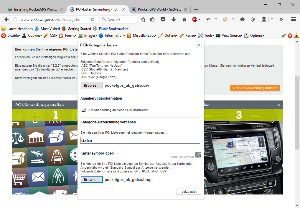

I then added these to the VW online tool (http://www.volkswagen.de/de/navigation/discover-pro/poi-listen-sammlung.html):
Make sure that 'Bei Annäherung an diese POIs informieren' is ticked. Then click on 'Jetzt laden'

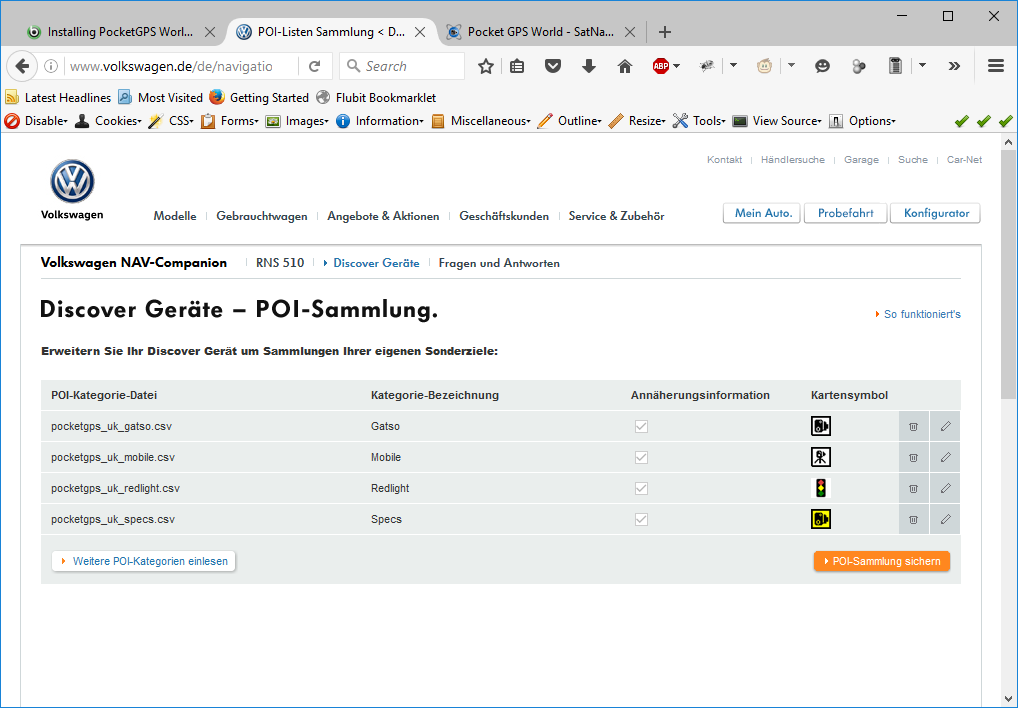

After adding all four files the screen looked like this:

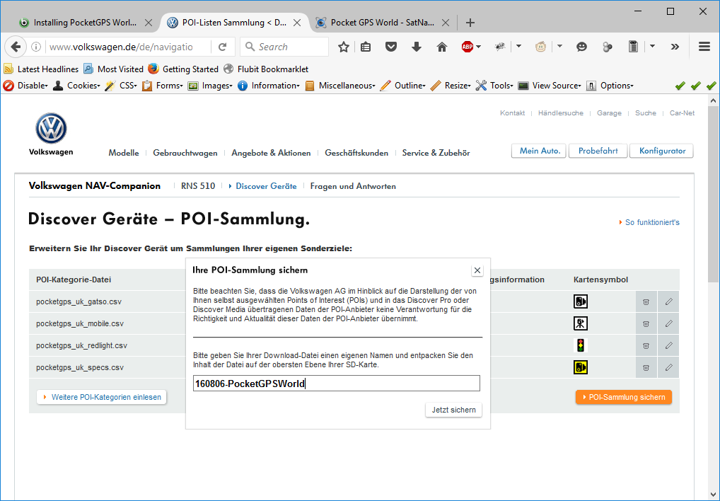

Click on 'POI-Sammlung sichern'
Enter a name for the file you will download and click on 'Jetzt sichern'

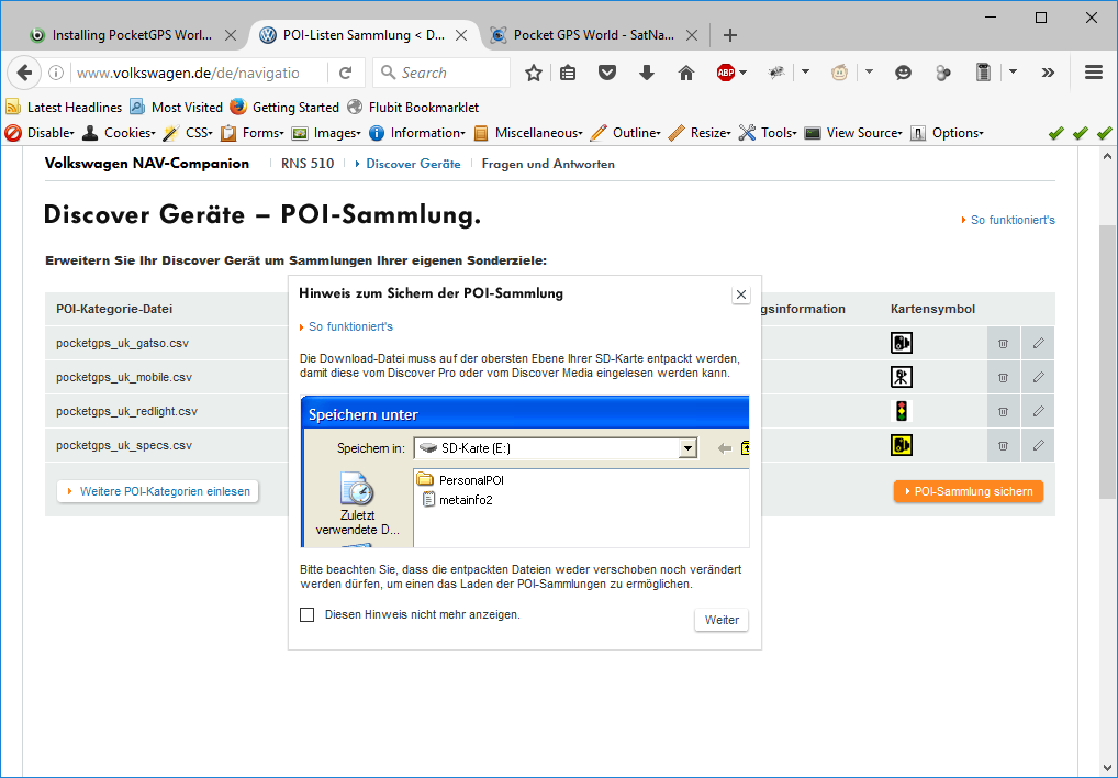

The last step in the online tool is to click 'Weiter'. This will then download the zip file to your PC.

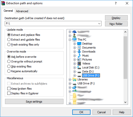

You then need to unzip this to a USB stick ready to load into the car (I used WinRAR)

Just to make sure others don't suffer from the same mistake as me - when you unpack the final zip file to a USB/SD card, make sure you only copy across the internal files, not the parent folder. You should have a folder named 'PersonalPOI' and a file named 'metainfo2' - that's it!
