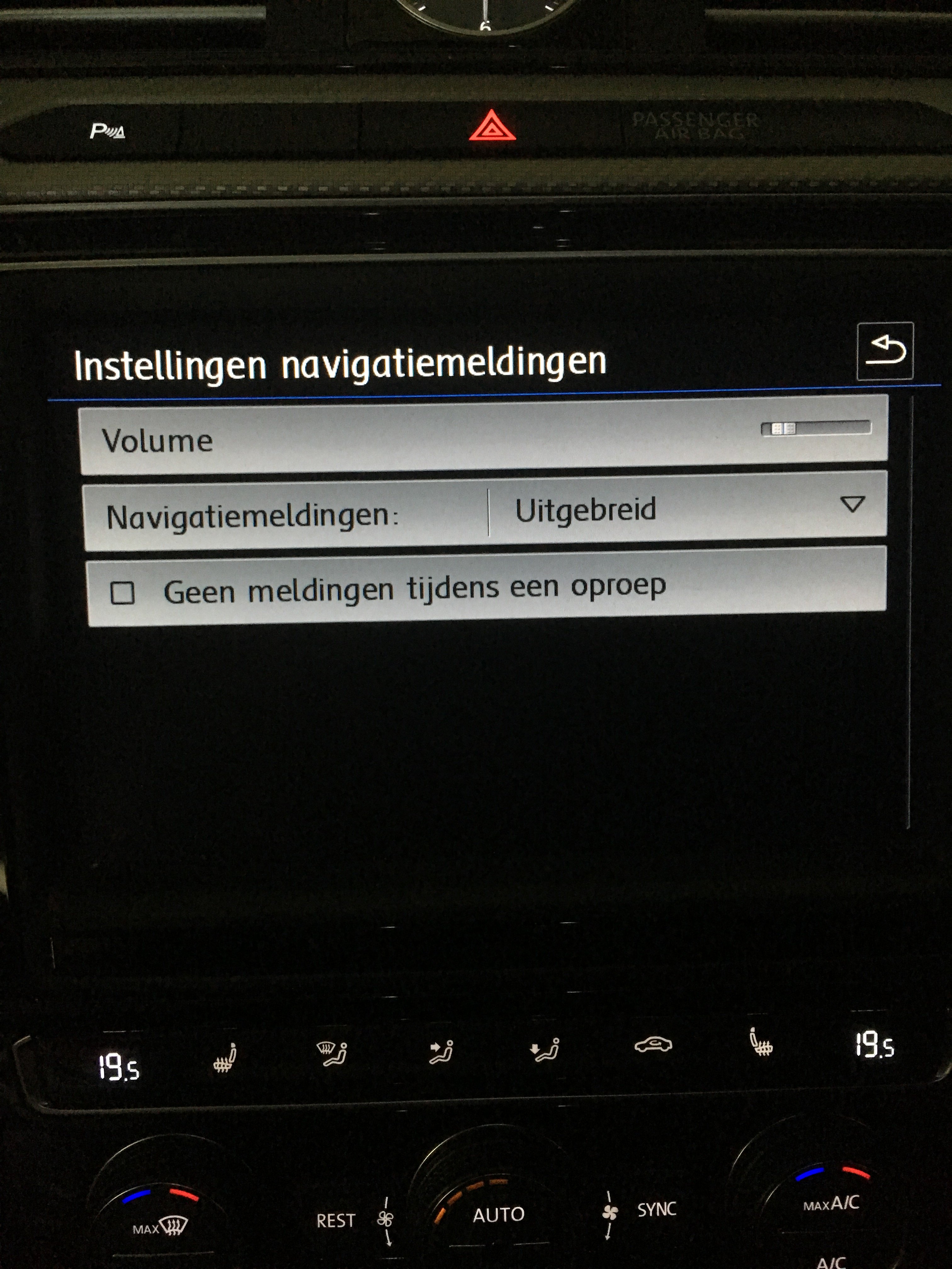

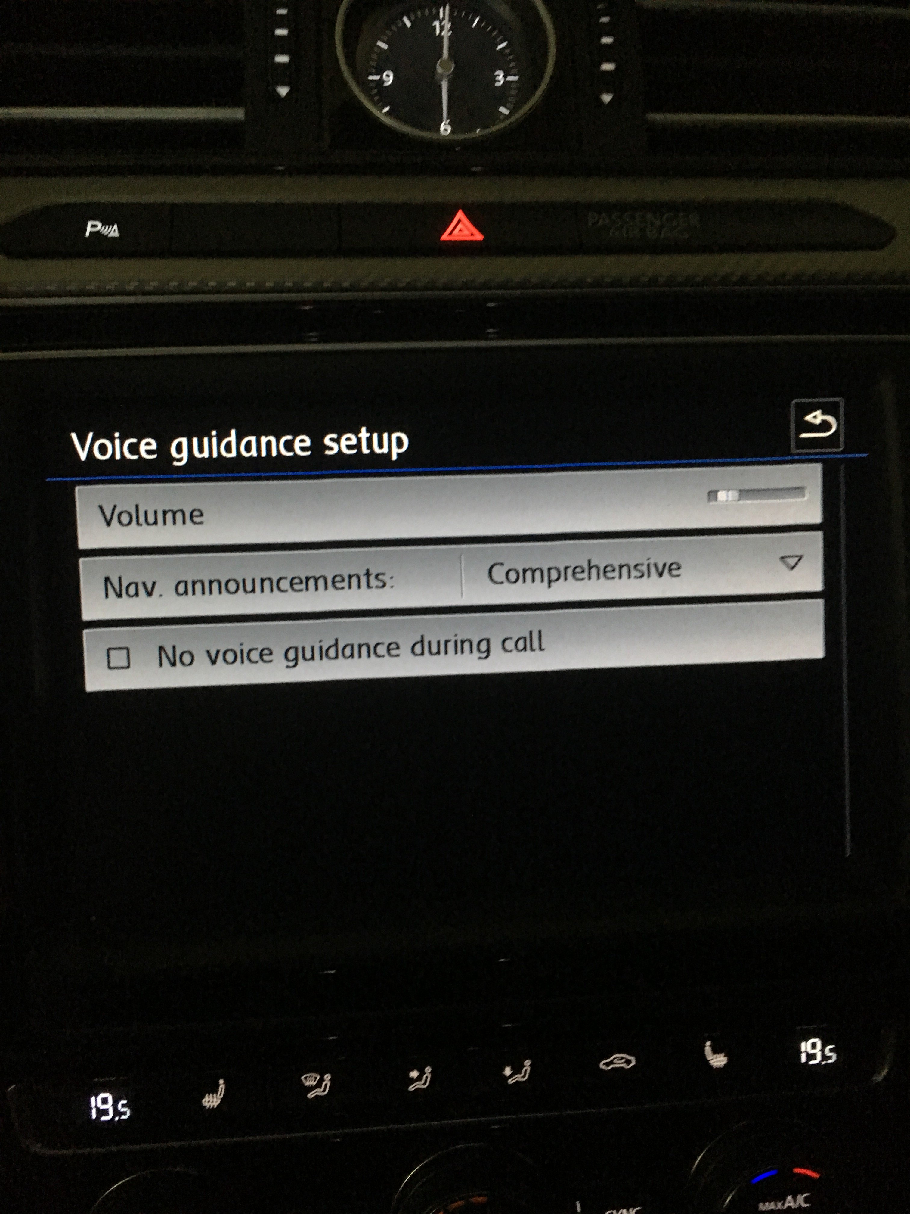

Hello,
I did everything like you said. But I don't have the option "Note my POI" in navigation announcements.
View my pictures please and hopefully someone can help me.
