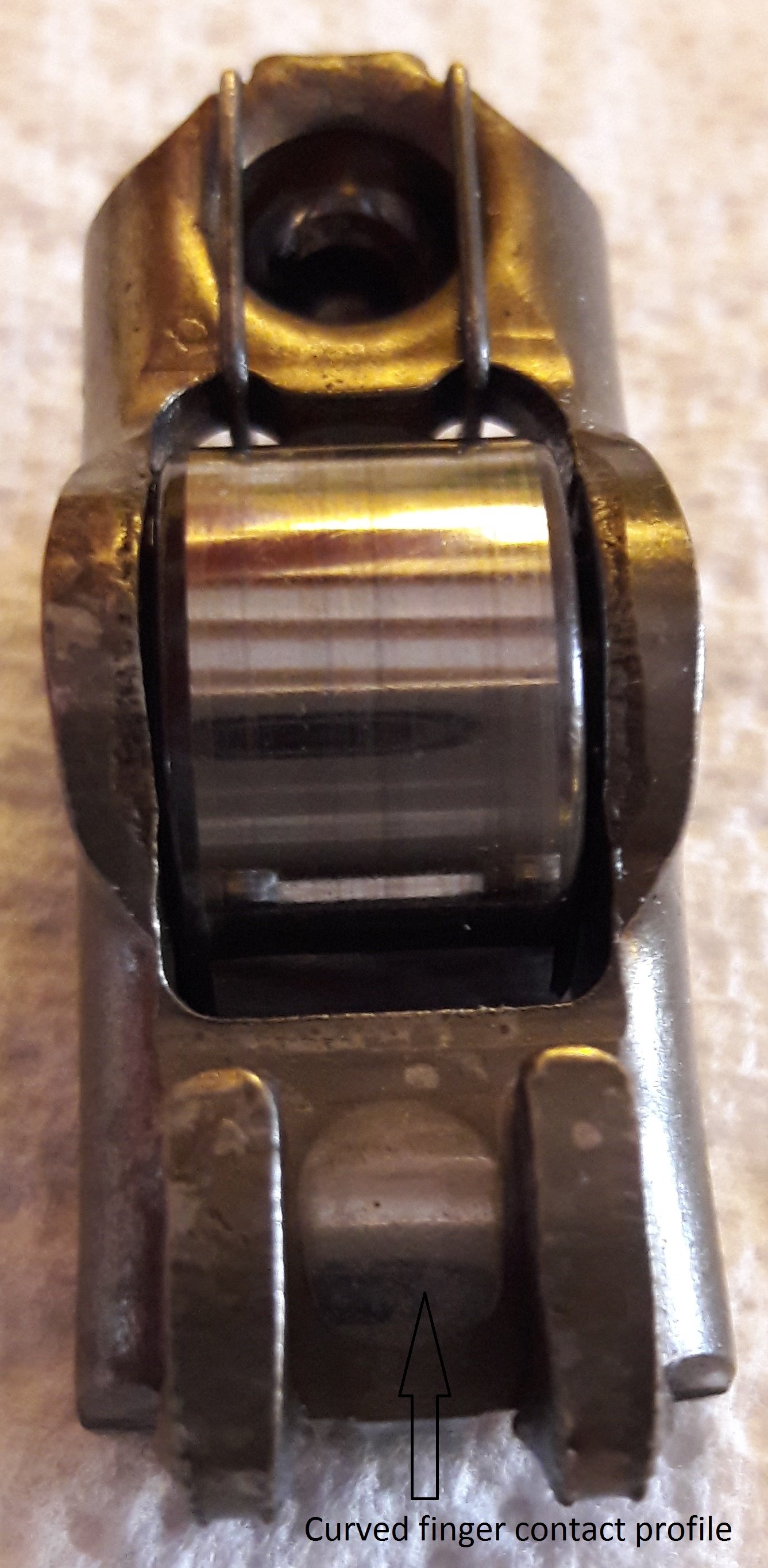

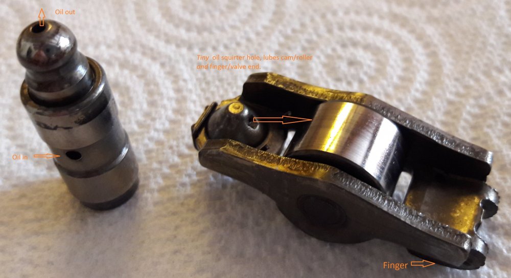

As far as I can see from a mixture of SSP reading and looking at real bits, the oil feed which ends up lubricating the contact between the tip of the valve stem and the rocker finger might easily be badly affected by 'past-its best' oil.
The feed comes in from a gallery in the head into the side of the 'hydraulic support elements', does its job of taking up the lash in there, then emerges out of the top end of the element into the space inside a ball-and-socket joint with the rocker. At an angle in that socket there's a tiny oil squirter jet, somewhere in the region of 0.3mm diameter. You have to move it all around at different angles against a torch or something to even see that there's a hole there. I tried to photograph it without any success.  That squirter lubes both the cam lobe/roller interface, and I think the rocker finger/valve stem tip interface.  This latter one will tend to drag the valve stem sideways more and more, the worse the lubrication of that interface is. The underside of the finger has a curved surface that looks like it's meant to 'roll across' the end of the valve stem as it describes an arc and the valve goes straight up and down. If well-lubed, that shouldn't result in much lateral force, I don't think. If poorly lubed, it'll tend to drag the tip of the valve instead.
Some pics:
The tiny dimension of the oil squirter jet makes me think they could easily get partially blocked by build up/condensation of solids within the oil, if it is allowed to deteriorate excessively.
Higher temperatures won't help, I don't think, so there could be a vicious circle of poor oil, more friction, more heat, even worse lubrication, maybe..
I reckon a clean-out of those holes would be part of my refurb procedure, but not sure what I would use. Even the smallest of those TePe Interdental brushes is too big to fit at 0.4mm, I just tried...
