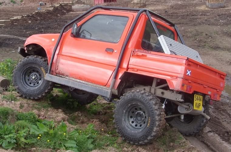

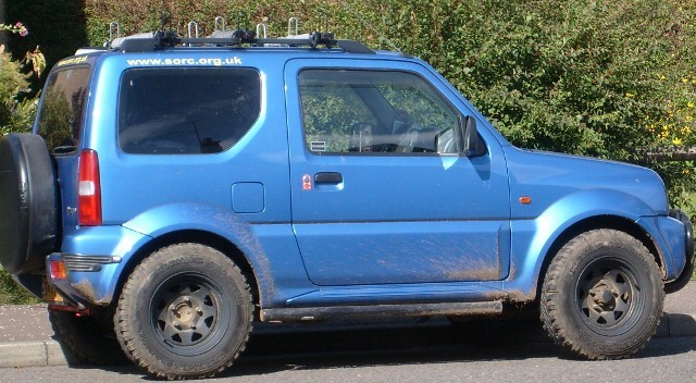

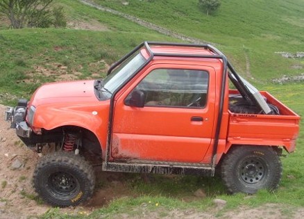

I also have a 2003 Jimny Auto i bought new, standard other than 2" lift springs & big wheels tyres and done 45,000 miles.
Needed welding at the body mounts this year.
A new Cat 2 years ago. Nothing else much in 13 years, rear dampers, front bearings, discs & pads.
Rust in the chassis and on the body near the mounts to the chassis is the issue to look for.
So many different engines, 1298, 1328 cc, 8 or 16 valve,
an Auto worth getting and the manual change transfer box not a push button one.
A standard one will go  most places (& get back).  There is an old thread in general car chat.
KAP Suzuki built the Orange Pickup for me 7 or 8 years ago.
