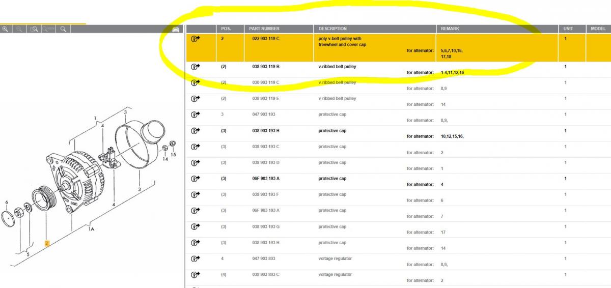

How many mk 1 owners have got a clutch pulley on their alternator? Reason I ask is that on mine it has a fixed pulley, but the oe system lists it as clutch type, the webcat we use also says clutch pulley, and a few underbonnet pics I have seen also show a clutch pulley??? slightly confused now.....

according parts catalogue
Just the diesels. Petrols are fixed.
