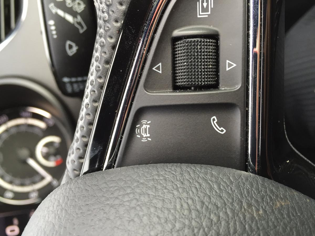

The button on my steering wheel with a phone on doesn't do anything, but had a Rapid Spaceback as a courtesy car yesterday with the same button and this one did work.

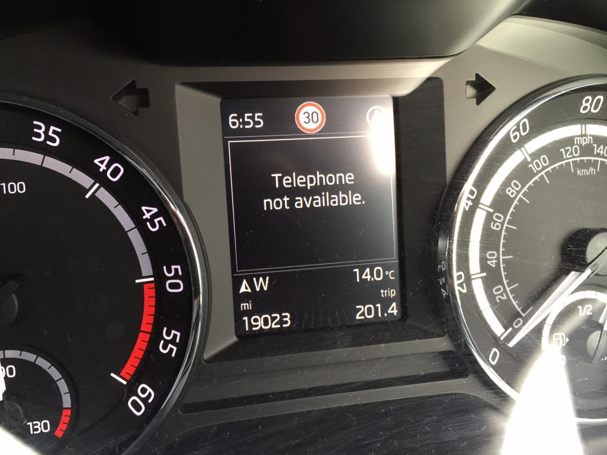

When I press mine, it just says 'telephone not available' whether the phone is connected or not, any ideas?

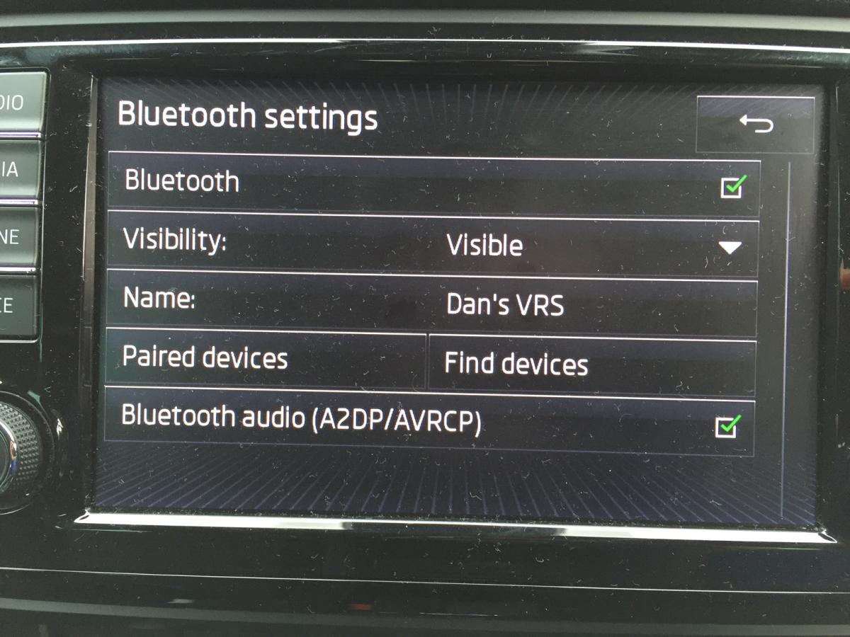

Try to reset the telephone and the bluetooth to factory settings and reconnect your phone again
Yep as long as your bluetooth connection is properly set, check the bluetooth settings on the phone, when you press this button, its a shortcut into the phone screen, which shows the phone name, signal, battery and network etc.
If you then press it again, it shows your call list and you can use the roller button to select and dial a number.
Worse case, delete the Bluetooth connection for your phone in the system, and then reconnect it again.

Just tried deleting the pairing from the car and the phone and reconnect but still no joy, bloody thing!
