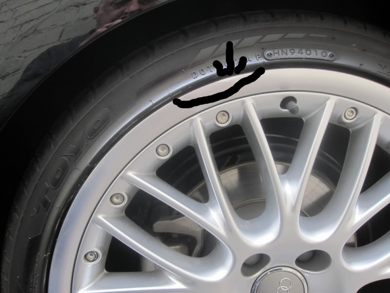

I kerbed a diamond cut on a TT I had, nightmare !!!! Some wheel dealers wouldn't touch it, others said it would have to be sent away, and take approx 1 week. As I didn't have a spare, that was no good.
Anyway, I've repaired a kerbed alloy before, and it's actually quite simple, so I decided to have a go at the diamond cut...I had nothing to lose.
Apology for the poop pic, but, this was after I'd done it myself..... The black line shows approx the area kerbed, and the 'arrow' down shows the only part of the repair visible after I'd finished. I'm quite sure if I'd taken the tyre off, I would have sorted that too:-)
That's pretty good, what did you use?
Very fine wet and dry...I used little to no pressure, ensuring the paper was kept very wet all the time, whilst constantly cleaning the area...A bit like a tattoo artist does. Patience is the key.................

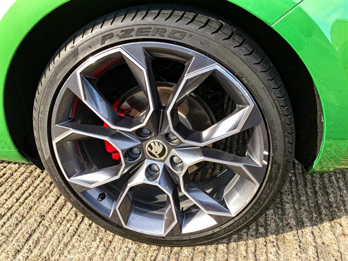

Does anyone know if there are touch up paints or pens preferably that I can obtain to make my 19' Xtremes look a little better?
the car came with 2 moderately scuffed alloys, both passenger sides.
The silver face of the extremes are diamond cut - ie done on a machine and the silver finish is actually the shiny alloy - this is then covered in clear coat. Any touch up would still stand out and look little better than they are now. You would need to get an extremely ( :nerd: ) bright silver in order for it to remotely resemble the cut alloy finish.
Was thinking more to the painted parts of the wheels
Edited by VRS_Dan
Bummer. Maybe try to get the code from Skoda and have Halfords or chipex make up a tin/bottle.
You could try Peugeot Steel grey - looks like a fair match
Course this wouldn't happen if you didn't get those awful Xtremes. I wish I could see what people see in such an ugly wheel.
If you check, the OP states he has "standard vrs wheels" so probably Gemini or Pictoris wheels?
Be a dull old world if we all liked the same thing.
I wasn't convinced to start with, but as they happened to be already fitted to my ex-demo VRS I have learned to like them. They look good with the grey paint and red callipers...IMHO of course.
Thought they were the standard as most VRS's seem to have them.
The Gemini are diamond cut as well...
I've only seen one VRS without Gemini wheels to be fair!
I have a tin of Anthracite Grey from when I fitted a colour coded bonnet strut to my previous Octavia - might spray something up and compare the colour (obviously as a temporary repair/cover up)
But only the Anthracite Grey ones. Mine is silver colour and it`s not diamond cut but kerbed  :dull:
I'm sure a silver touch up will work just fine then... Will surley look better than bare kerbing. Dealer might well sell a touch up pen in the right colour. Kerbing on the anthracite ones stand out even more!
