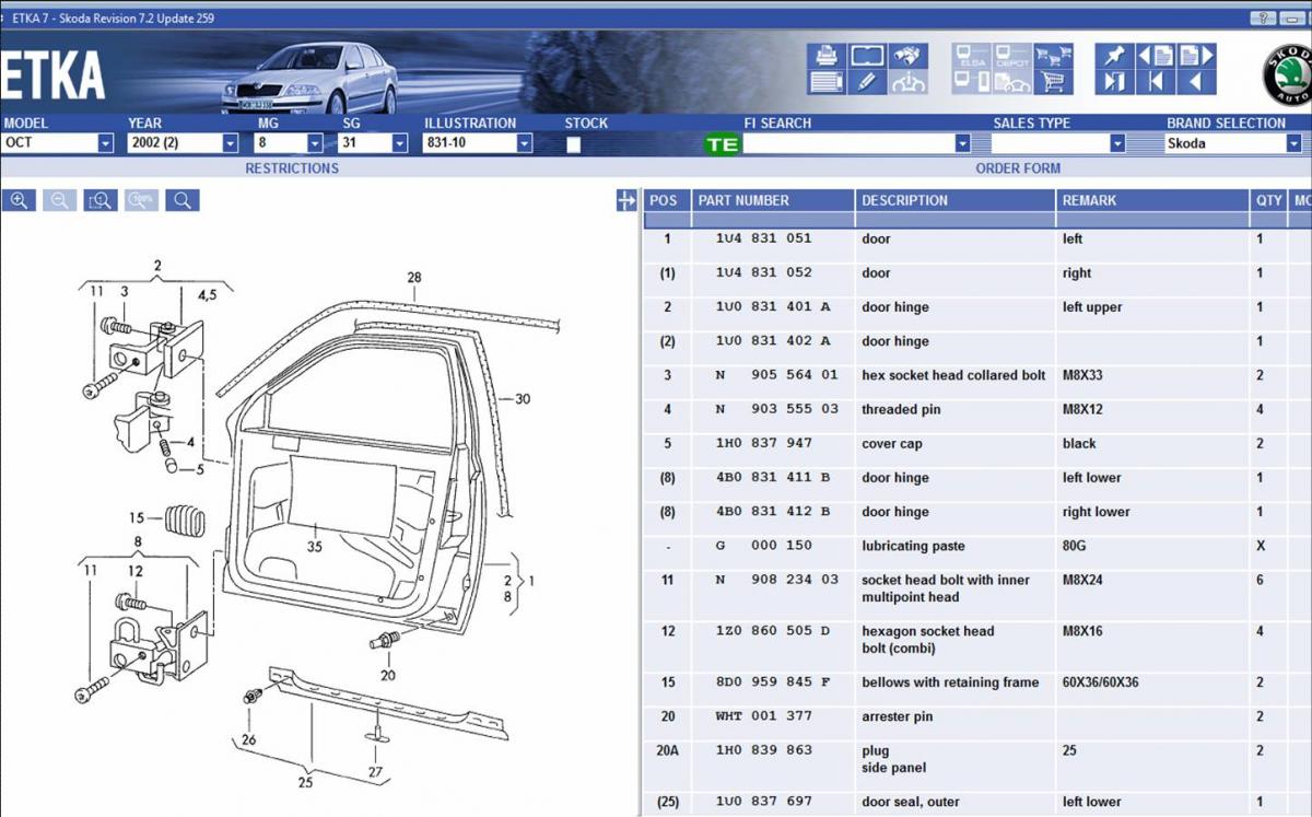

Yes they can be bought see pic:-
Removing the top bolt on the lower hinge is a pain! You need like and allen key type tool but with a Torx head or you have to cut it off, so best off buying new bolts if you go down that rout. Otherwise not a bad job.
O right i see damn that how much are they new as that picture dosent say or even if you could tell me the website you saw them on would be grate has any one ever done a how to guide on the hinges before thanks again for all your help
