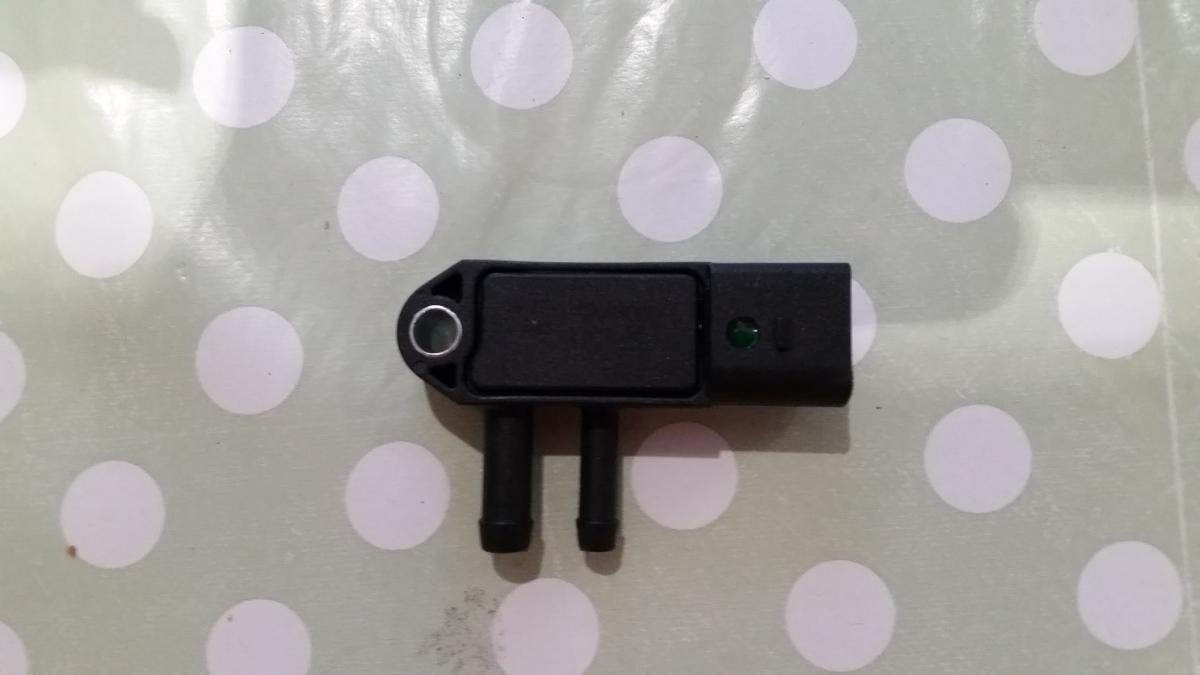

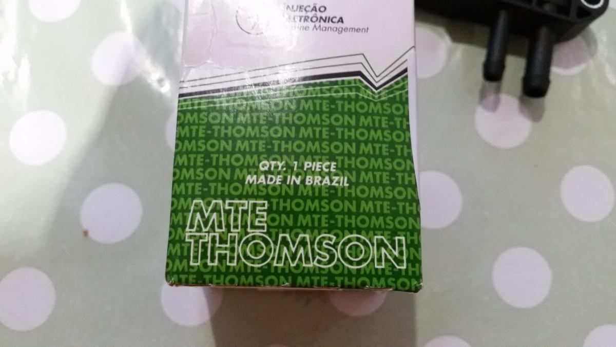

Ok so Euro Car Parts sent the DPF out which has arrived very quickly total cost £37.49!!!
At the time Euro could not tell me who made this part so I thought I would share the info. Its made by MTE THOMSON from BRAZIL!!!!
I have attached some pictures for your reference I will report my findings once installed.
