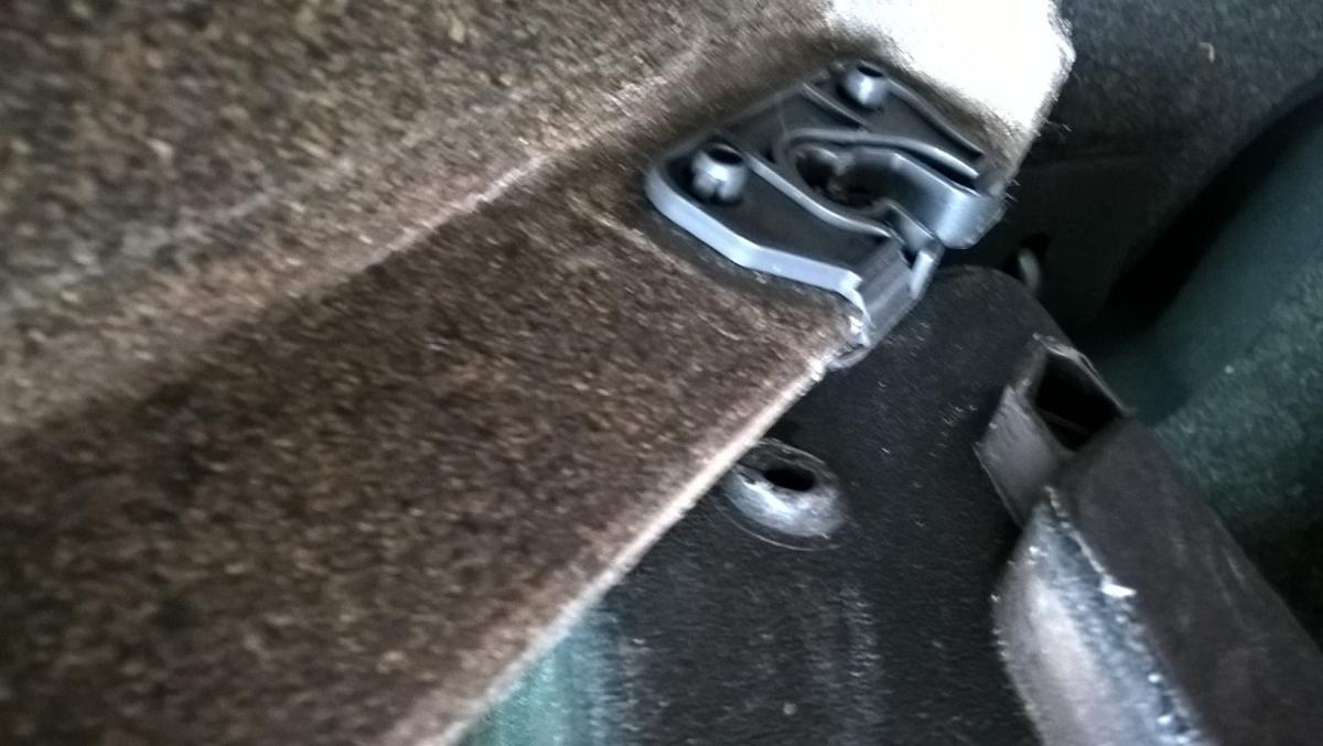

Can the bonnet support holder be purchased separately? Re the Toyota part, it split from the main panel.
Yer I belive so. Pic of Toyota issue

Hi J306TD, attached is a picture of the Toyota issue.
If it were me I'd glue the snapped lug on with Araldite or JB Coldweld, but not before putting a bolt through from the other side, with a nice big repair washer to reinforce it.  If I didn't have the lug, I'd probably just sleeve the bolt (as a replacement to the lug) with a bit of plastic tubing.
Having said that, why not just replace the broken panel, either with new, or from a scrappy if it's pricey new.

For a Toyota that looks remarkably similar to the parcel shelf issues on the Fabia 2
Gaz
I did try Q-Bond, but it didn't work. I think the problem with Q-Bond is getting the powder to fill the crack, given the position of the broken part.
