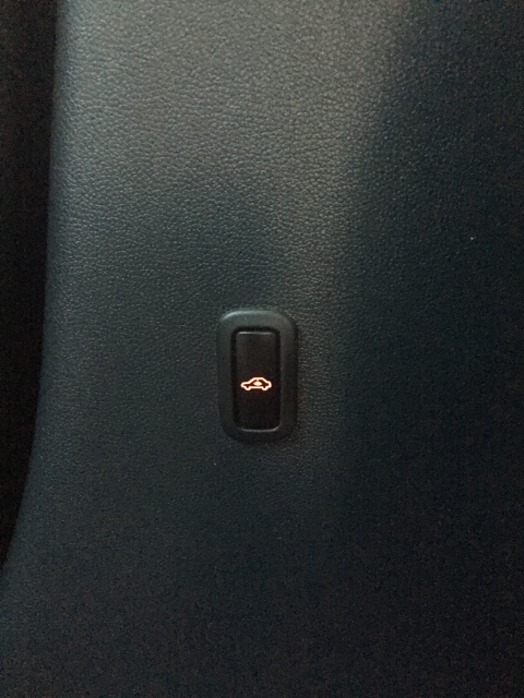

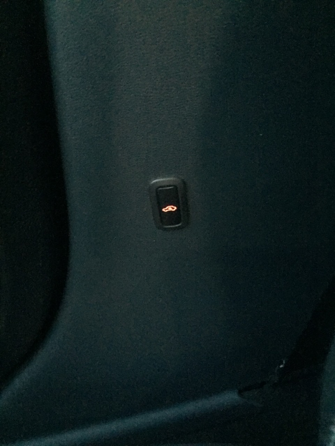

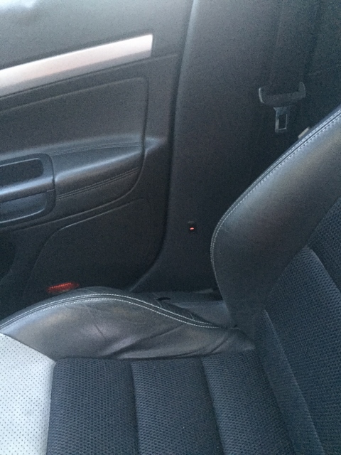

I have a 2006 Pre FL octavia vRS.
This button is located next to the drivers side seat on the lower section of the B pillar
What does it do?

Disables the alarm temporarily I believe.
Turns off some of the alarm functions to allow you to leave a moving object such as the wife, kids, pet in the car after you lock it with the remote.

 You press it before you lock it and the interior sensor is disabled. The next time you lock it it will work as normal.
I think this also disables the tilt sensor as well so you can jack your car up or tow it away with it locked
Turns off the internal motion sensors.
All other inputs remain active.
Press the button (it changes colour) then lock the car as normal.
Good for travelling on ferries etc.

Button does the same as a double press of the lock button I believe.
