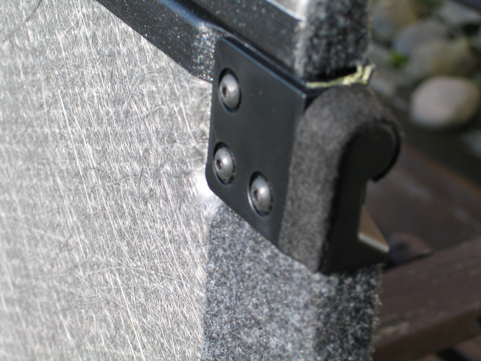

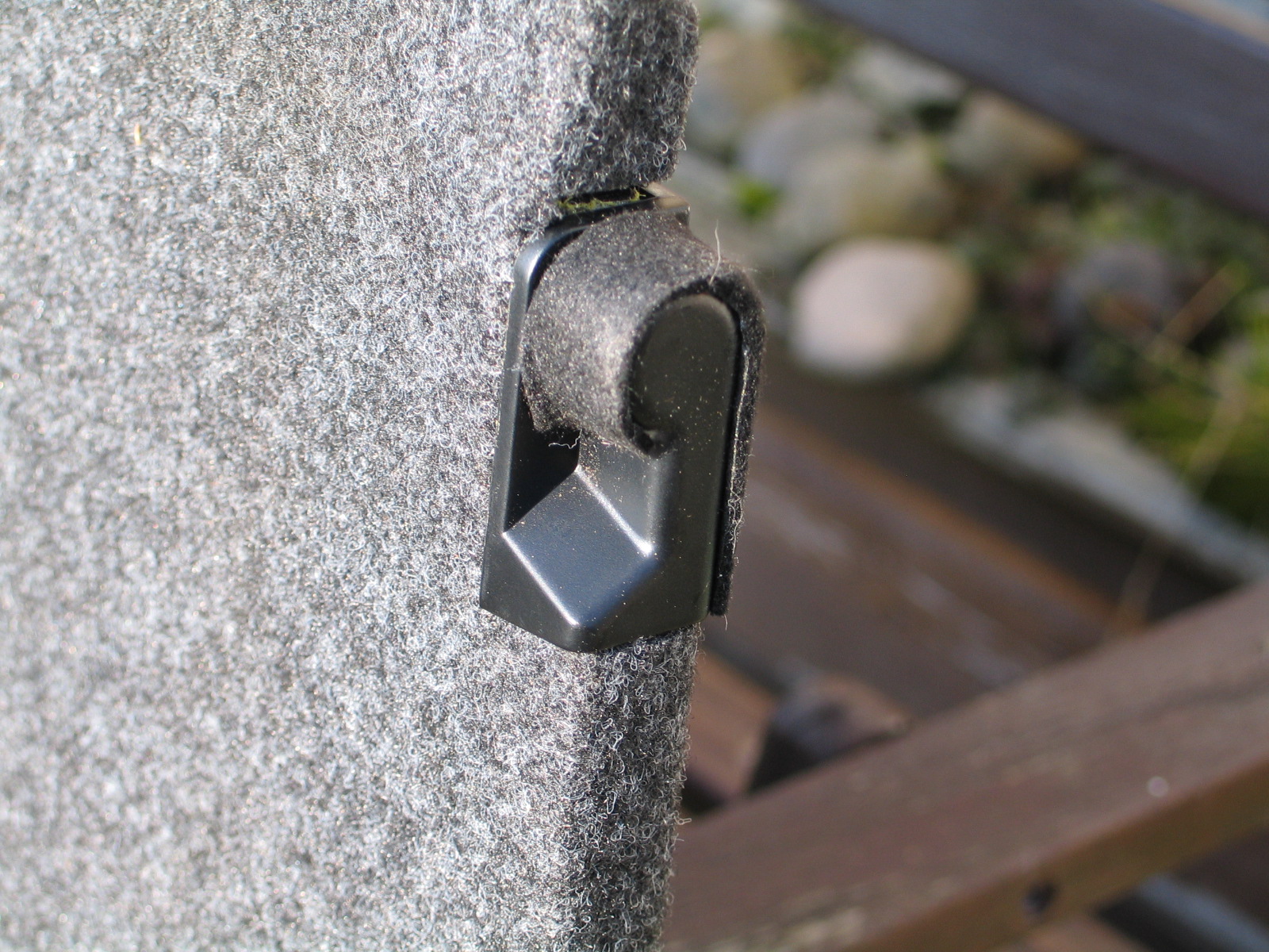

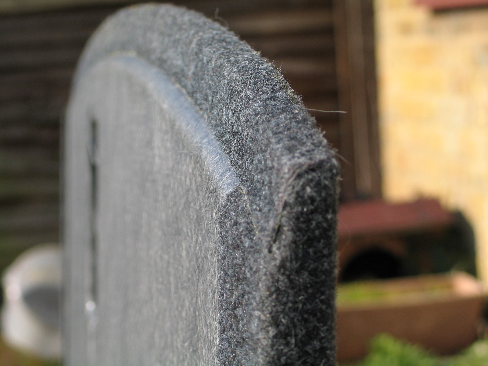

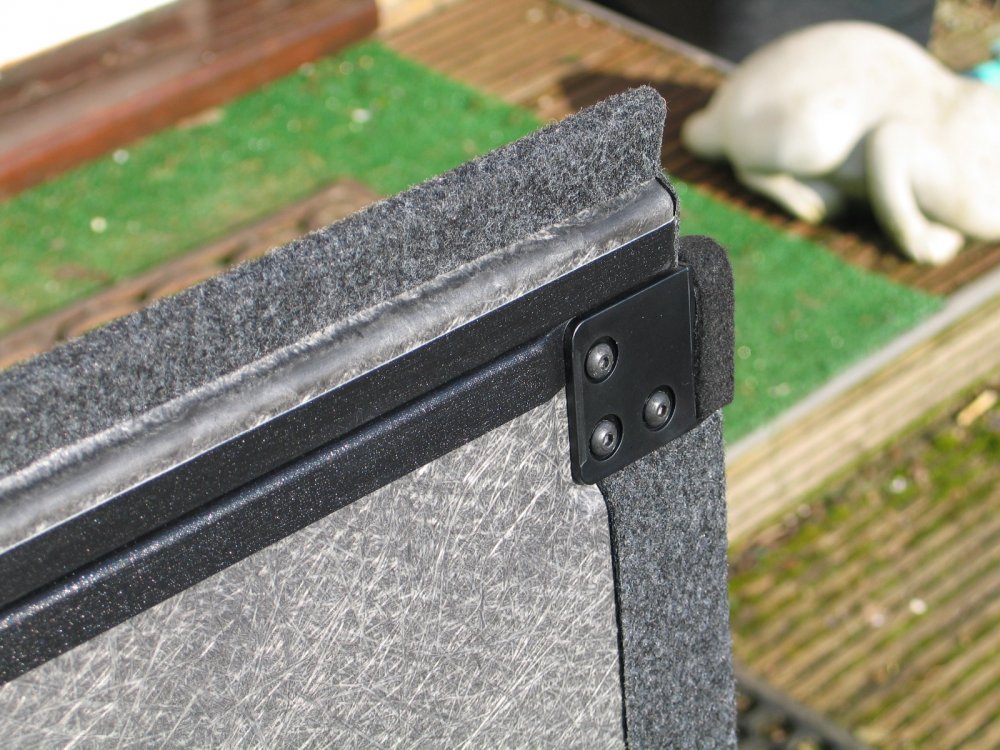

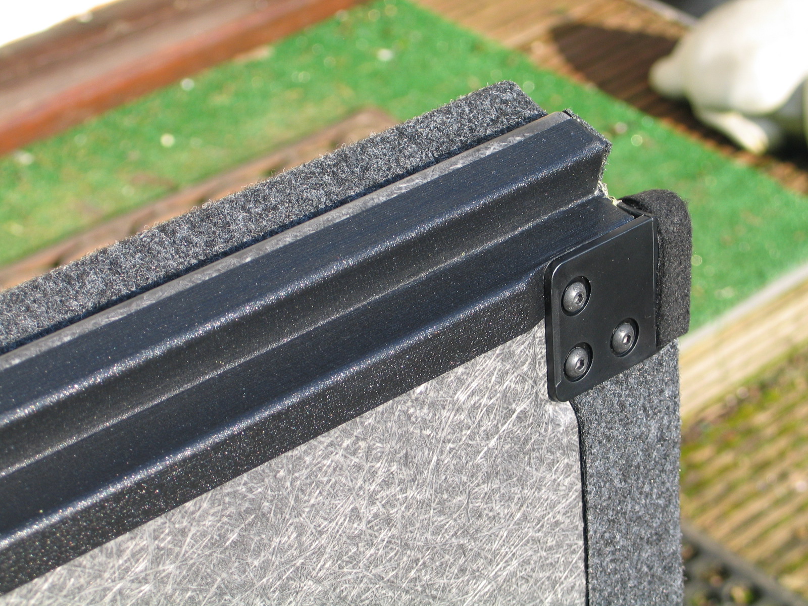

I would also like to make a VBF with MDF. Can someone post photos and dimensions?
Part number is 6V9 861 529 and there's currently one for sale in Germany on ebay.
Width is 954mm
Length is 910mm at its longest (curved at tailgate end)
There are images on Google. There are two areas that may be troublesome,
1-The attachments at the seat end which holds them in place and allows it to pivot easily
2-The thickness at the curved end that is profiled to allow it to sit on the fixed plastic trim
I'll try to post some pictures tomorrow.
Neil.
Here are the pictures:
The top side of the pivot bracket
The bottom side of the pivot bracket
The hinged back strip
The hinged back strip open
The bottom of the curved tailgate end showing the profile on the end
Hope these help.
Neil.
Thank you for these detailed photos! It's more complicated than I thought ...
