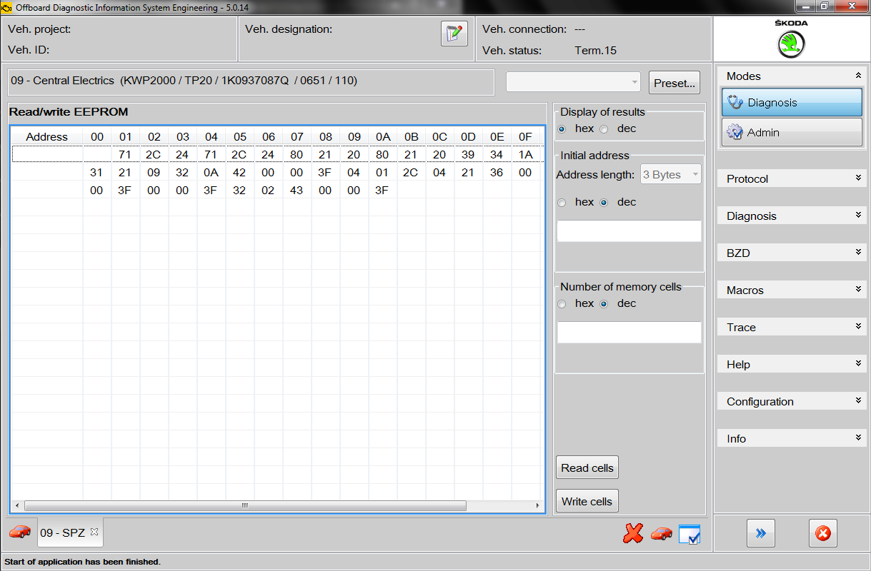

An AB rev should be fine. This isn't something VCDS can typically do so I use ODIS-e to directly edit the EEPROM rather than using byte 18. Where are you based?

It's not as simple as choosing a setting, you'll need to editing individual bits in the BCM EEPROM to sort it. For example, this is a MK2 FL Octavia vRS with dual rear fog lights enabled:
Is it ODIS-e (engineering) or ODIS-s (service) you have access to?
Assuming it's ODIS-e and if I can get remote access, drop me a PM as I should be able to help :)
